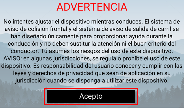

When the device is first powered on a product usage agreement screen will appear briefly. Select the Accept button at the bottom.

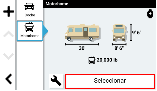

1. Select the Vehicle Profile
    • If not prompted for the profile skip this step

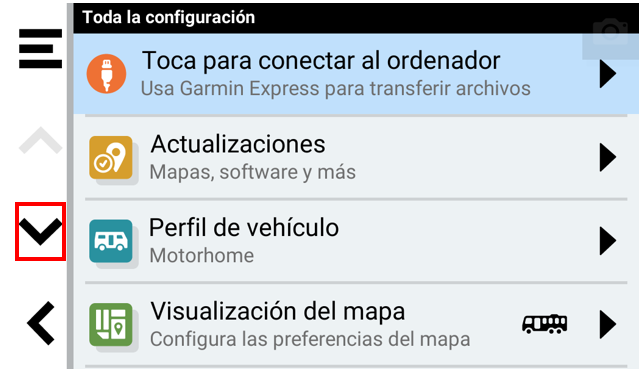

2. Touch the Gear icon on the screen with the magnifying glass and map icons
3. Touch the down arrow

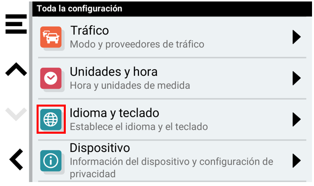

4. Touch the "Globe" icon

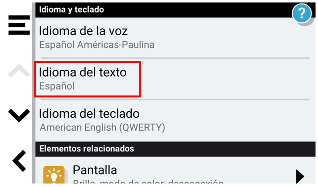

5. Touch the second option from the top

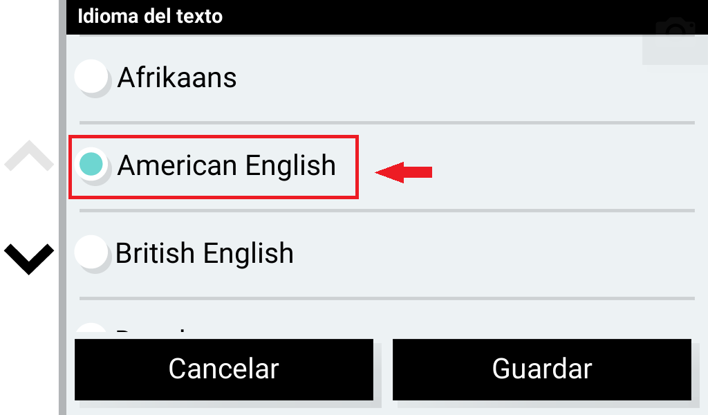

6. Touch the up or down arrow until you find the desired language
7. Touch the desired language to select it

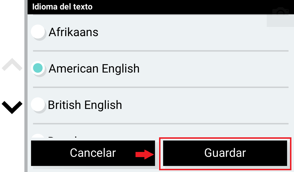

8. Touch the lower right-hand button to Save
The device should now be in the selected text language.
