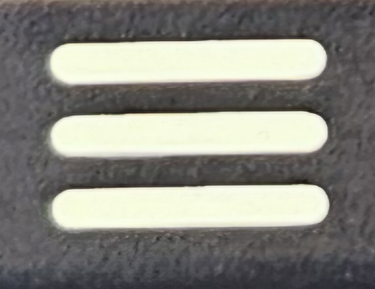

On the GHC™ 20 select the Menu / Menu Button >  Setup > System > System Information > press and hold the center soft key until Dealer Mode displays > press the back button twice > Dealer Autopilot Setup > Wizards > Sea Trial Wizard
