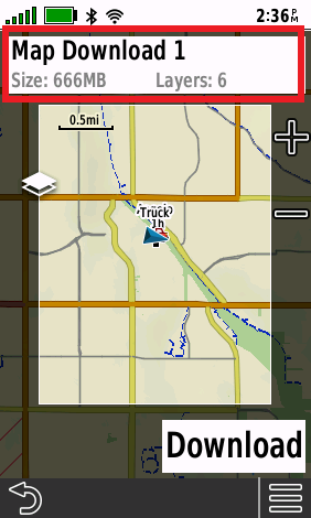

Downloading Satellite Imagery With an Outdoor Maps+ Subscription
  1. Select Home Icon to access the main menu.
  2. Select Map Manager.
    • This option can also be accessed from the map page by selecting 3 Lines Menu Symbol, then Map Setup.
  3. Select Outdoor Maps+.
  4. Select Add Satellite Imagery.
    If Bluetooth or Wi-Fi have not already been setup, follow the prompts on the device to set them up.
  5. The handheld will display Requesting Map Update Data while it connects to Wi-Fi.
  6. Select Use Map, or select a category to center the download over a specific point on the map (e.g. Cities > Olathe, Kansas > Use).
  7. Follow the on screen instructions to download your selected area.
    • To view different areas of the map, press/drag the map with your finger. You can zoom in and out of the map, but may need to zoom in to a scale of 2 miles or less if certain layers like Satellite or USGS quadrangle map are needed.
  8. Select Map Download.
    Map Download Layers
  9. Toggle on or off the various layers you would like to download (list of layers available may be different than shown below).
    Layers
  10. Use the back arrow to get to the Download screen.
  11. Select Download. Once complete, the imagery will appear in the Outdoor Maps+ list with the name and size of the file.

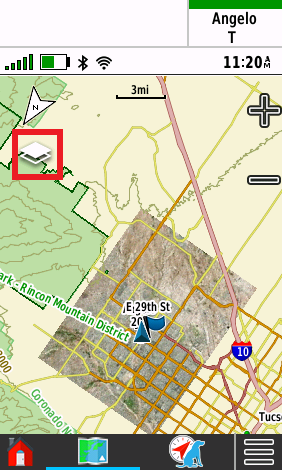

Viewing the Satellite Imagery on the Map
  4. Select the file you wish to view.
The imagery will also appear on the Map page. You can toggle on or off layers as desired when you are in the area to view either the downloaded satellite imagery or the TopoActive base map.
layers button on map  toggle map selection
