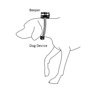

  • The dog collar, the beeper, and the handheld must all be turned on
  • The dog collar and the beeper must be in the correct orientation on the dog's collar strap. The diagram below shows the correct 12 o'clock / 6 o'clock position.
beeperdogdevice
