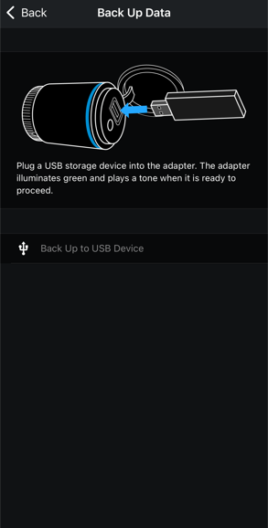

2. Touch Settings
3. Touch Back Up Data
4. Insert a USB storage device into the USB port on the Garmin eLog adapter
  • The light ring on the adapter glows green and plays a tone when it is ready to back up data.

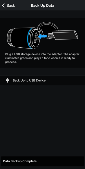

5. Touch Back Up to USB Device
6. The Garmin eLog App will begin backing up data to the USB Device
7. A "Data Backup Complete" message will appear when the backup is finished

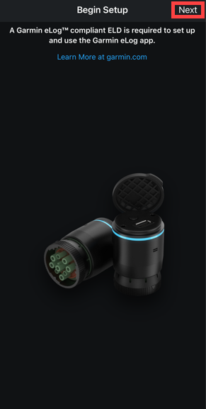

1. Open the Garmin eLog App to start the setup process
2. Read and agree to the Terms of Use and touch Continue
3. Touch Next
4. Follow the on-screen instructions to install the Garmin eLog adapter in the vehicle diagnostic port. Then touch Next.

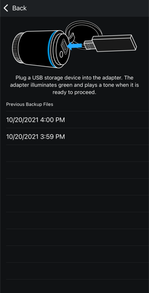

5. Complete the pairing process. Then touch Restore from Backup.
6. Insert a USB storage device containing backup files into the USB port on the Garmin eLog adapter
  • The light ring on the adapter glows green and plays a tone when it is ready to restore data.
7. Select a backup file
8. Select Restore

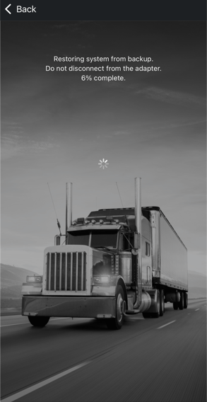

8. The Garmin eLog App will begin restoring data from the backup

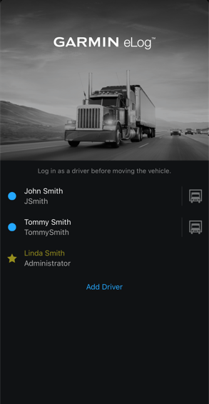

9. The profile log in screen will appear and data will be restored
