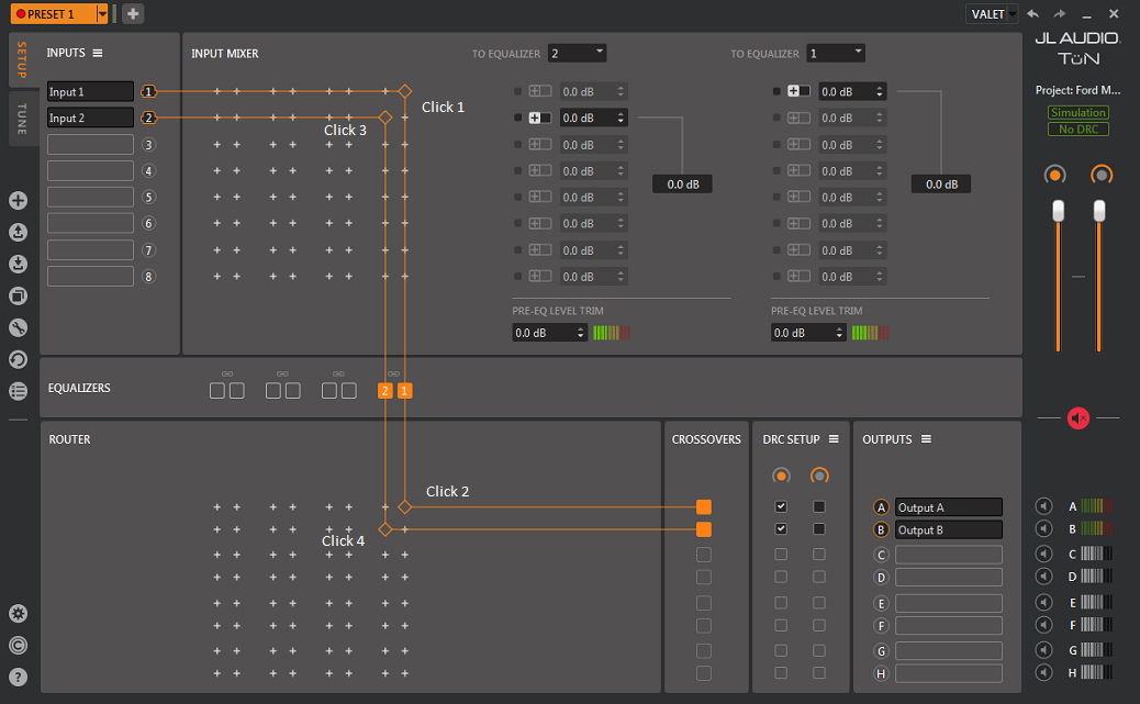

At first glance, the interface might look a little intimidating, but soon you will realize that routing a signal is usually as simple as two mouse clicks. The mixer itself is made up of a grid of “+” icons. When a “+” above the EQ Banks is clicked, it creates a link from an “Input” to the corresponding “EQ Bank”. A second click on the grid below the EQ Banks, creates a link to one of the “Outputs”.
Let’s look at a simple scenario where two channels of signal need to be run through EQ1 and EQ2 and out through outputs A & B.
Beginning with Input 1 there is a row of eight “+” icons.  Hover over the last icon and a temporary grey line will show a preview of the signal path from Input 1 to EQ 1. (Figure 1).
Figure 1
Click the “+” logo and the signal path turns orange and confirms that the audio signal is now routed to EQ 1.  (See figure 2, “Click 1”)
To set the Outputs, follow same process at the OUTPUTS section.  Find the “+” icon that links EQ1 to Output A and click it.  (See figure 2, “Click 2”)
There should now be an orange signal path running from Input 1 to EQ 1 to Output A.
For the right channel (or input 2) go to the second from last “+” icon which links up with EQ2 and click.  (See figure 2, “Click 3”)
Click on the “+” icon linking EQ2 and Output B and the routing is finished.  (See figure 2, “Click 4”) TwK Bypass Clicks
Figure 2
There are now two channels of input with separate EQ’s, each running to Outputs A & B.
Always remember: Click to connect, Right Click to Delete.
