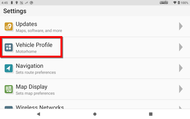

1. Touch Settings
2. Touch Vehicle Profile
