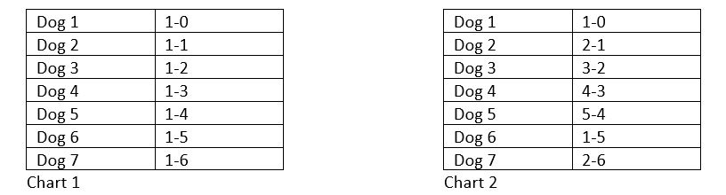

Frequency Overload
All of the dog frequencies being on 1 with the channel number being right next to each other can cause symptoms of interference
frequency chart
  • Chart 1: All the dog collars frequencies are listed as ‘Frequency 1’ with the channel number being right next to each other can cause symptoms of interference.
  • Chart 2: The channel numbers are spread throughout the frequencies; there is not just one frequency being used.
    • The channels are also spread out between similar frequencies, as shown in Dog 1 and Dog 5.
