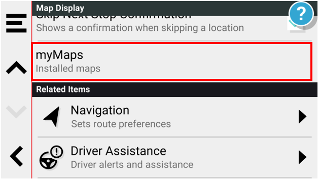

To Check the Mapping:
1. Touch Settings
2. Touch Map Display
3. Arrow down and Touch myMaps
4. Touch the down arrow to expand the map list

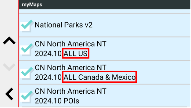

Make note of the name of the map region, which is listed next to the map version.
Devices loaded with North America mapping will have the map displayed as two separate entries:
- CN North America ALL Canada and Mexico
- CN North America ALL US
See the FAQ North America Coverage for more information.
If your device does not have both of the above entries, see the FAQ Maps Missing After Updating Maps on a Full Coverage Automotive Device for further troubleshooting steps.
