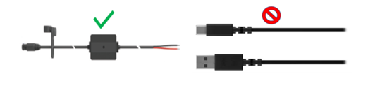

- Make sure your device is plugged directly into your vehicle with its original Garmin power cable
Do not use a splitter, USB, or third-party cable.
Ensure the High-Current Power Cable is securely connected to the antenna mount.
A replacement High-Current Power Cable can be purchased if necessary.
