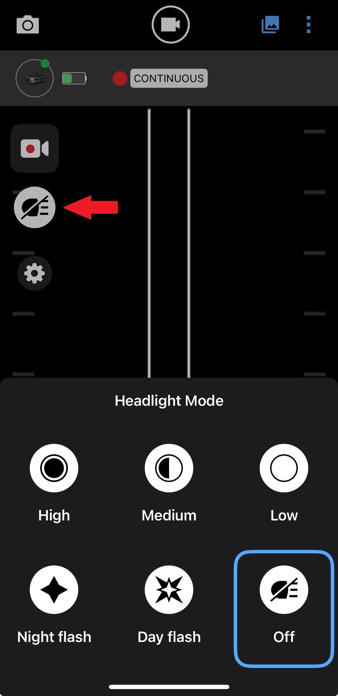

Light Controls
The Varia app can be used to change the headlight setting of the Varia Vue, switching between the six available light modes. If only a Varia Vue is paired to the app, these options will be shown on the main screen of the app. If both a Vue and a rear radar are paired, the light controls will be hidden to allow the radar readout to appear on the screen. To access the light controls, select the icon of the Varia Vue to open the options for the device. Select the light control icon located between the camera and settings options to change the headlight mode.
Varia app with Headlight Mode options for the headlight, with off selected
