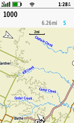

Examples of Enabled Mapping
List of Enabled Maps Showing Toggles Up and BlueMap Page Showing Map Detail
Examples above are from a GPSMAP® 66sr and may look slightly different on other handheld models.

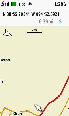

Examples of Disabled Mapping
List of Disabled Maps Showing Toggles Down and GrayMap Page Not Showing Map Detail
