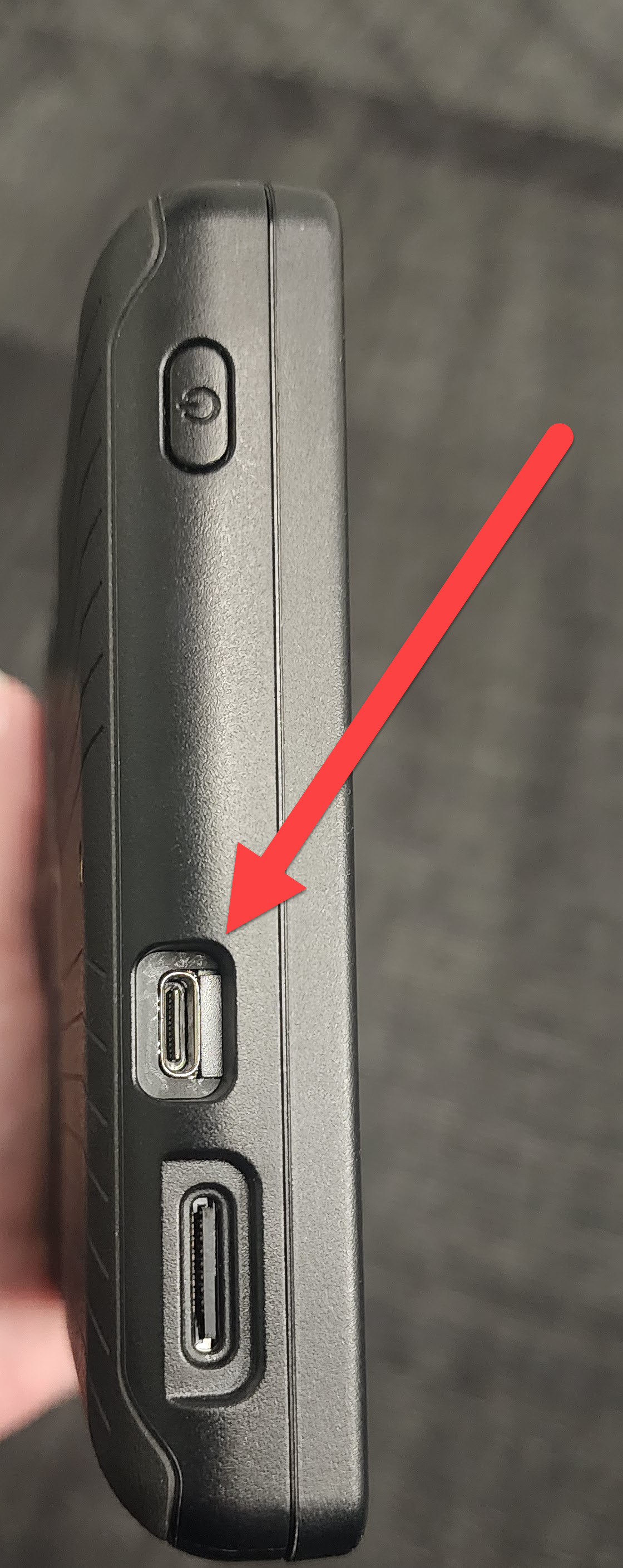

The message USB on wrong port indicates that the USB cable is plugged into the wrong USB port.
To perform database or software updates, use the USB port on the left-hand side of the aera® 795 or aera® 796.
To connect the GXM 40 or GXM 42 antenna, use the USB port on the mount/cable.
