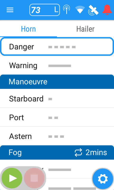

Selecting the Loudspeaker option brings the horn or hailer view.
Selecting the desired horn options, depending on the circumstances, will enable the loudspeaker to function as a horn.
Cortex Loud Hailer Options
The gear wheel at the bottom right of this view allows the user to change the pitch of the horn. Lower pitch allows the sound to travel longer distances and around obstacles better.
