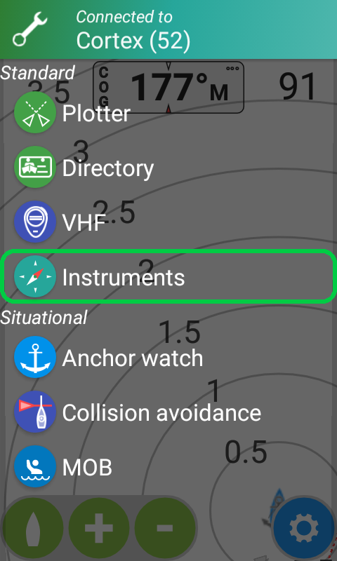

To utilize this function, start from the main menu screen by Highlighting or tapping on the Instruments Icon.
Cortex Instruments page
The Instruments view page opens.

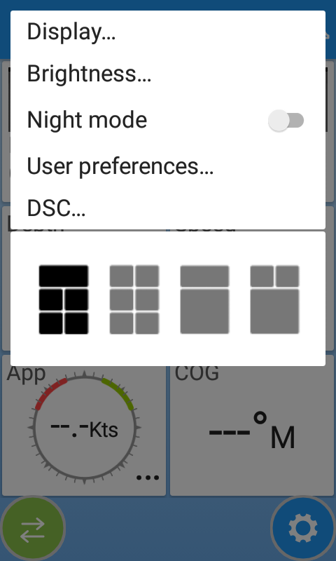

Change the layout of the instruments by simply selecting the preferred format.
instruments options

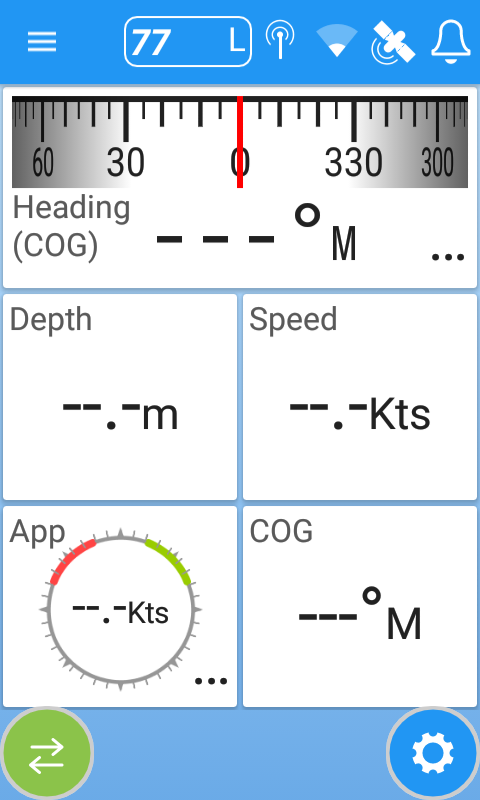

Back to the instrument view, a button with a green arrow or a lock on the bottom left. Tapping the visible arrows allows you to slide the available instruments into view in each instrument window by using a swipe gesture with your finger. Once the desired instrument cluster is selected, tap on the arrows to lock the instrument view.
Instruments unlocked
The data presented can come from Cortex internal sources, the NMEA 2000 bus, or the NMEA 0183 input.
There are multiple choices here for the type of heading, and more than one heading can be displayed
  • Heading with fallback
  • External heading sensor (if available)
  • COG
  • Internal heading sensor (if calibrated)
Other options to display are
  • Depth
  • COG
  • SOG
  • Heading (COG)
  • Speed
  • Wind speed
  • Wind direction
  • Water Temp
