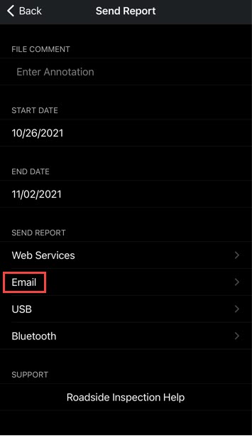

iOS
1. Open the Garmin eLog™ app
2. Sign in to your driver profile
3. Touch Inspection
4. Touch Send Report
  • Review data for accuracy prior to sending the report.
5. Touch Yes
6. Enter an annotation if necessary
  • Any key phrase or code provided by the DOT officer during the inspection should be entered here.
    • Special characters and spaces are not permitted and there is a maximum of 60 characters.
7. Change the date range if necessary
8. Touch Email
9. Enter an email address and touch Send Report
  • The app will display, "Enter an email address to receive confirmation from the FMCSA and Garmin about your data submission."
  • The confirmation email will include a copy of the RODS Report in .csv format.
 10. Touch OK
The email sent will have the RODS report attached.

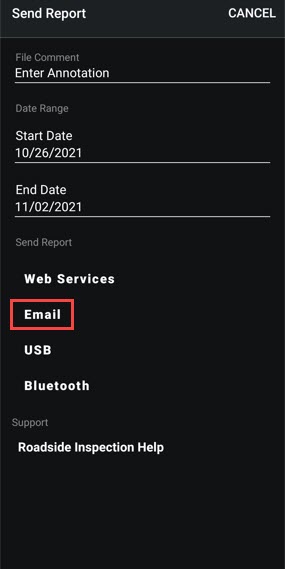

Android
3. Touch Inspection
4. Touch the send reports icon
5. Touch Yes
8. Touch Email
10. Touch OK

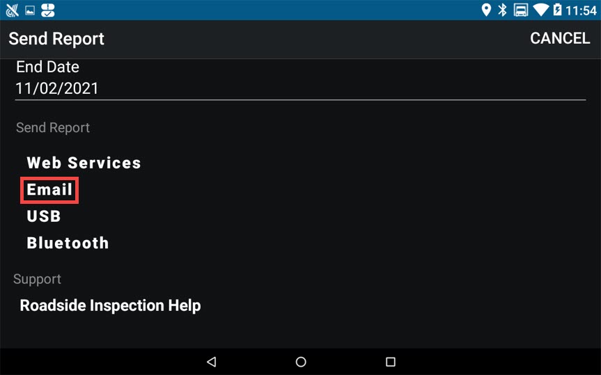

dēzl™ 780 or dēzlCam™ 785 GPS Navigators
NOTE: An active Wi-Fi connection is required for this process.
3. Touch Inspection
5. Touch Yes
8. Touch Email
10. Touch OK
dēzl™ OTR800, dēzl™ OTR810, dēzl™ OTR1000, or dēzl™ OTR1010 GPS Navigators
3. Touch Inspection
5. Touch Yes
8. Touch Email
10. Touch OK
