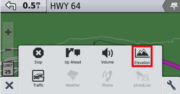

1. Touch View Map
2. Touch the 3 Bars
3. Touch Elevation

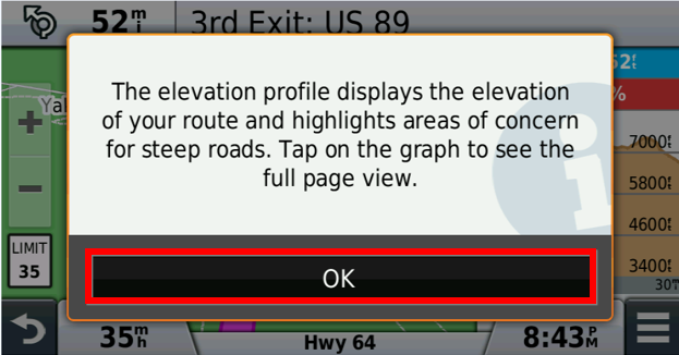

4. Touch OK if prompted
5. Touch the chart to expand it to the full screen
The device will now display the current elevation, distance to the next steep grade, and a chart of elevation over distance.
