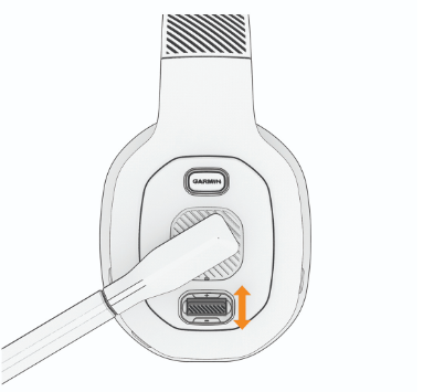

You can use the rocker on the dēzl™ Headset 100 and dēzl™ Headset 200 Premium Trucking Headsets to control the headset volume and music playback.
Controlling Media:
To increase or decrease the media volume, move the rocker up or down.
To play the next audio track, hold the rocker up.
To play the previous audio track, hold the rocker down.
To play, pause, or resume audio playback, press the rocker.
