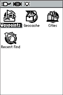

  1. Press the FIND key. The Find Page appears. Highlight Waypoints and press ENTER.
Find Page
  1. Use the ROCKER key to scroll down the list and highlight the waypoint you want to find. Press ENTER to select the waypoint. The Waypoint Information Page appears.
