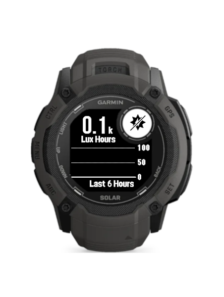

Understanding the Solar Widget
Solar Widget Examples
Instinct® Solar - Standard EditionInstinct® 2X Solar
Solar WidgetSolar Widget for Instinct Solar WatchSolar Widget on Instinct 2X Watch
  • The checkmark or slash indicates that the watch is fully charged and no solar charging is taking place. When solar charging is taking place, the checkmark or slash will be replaced by a graphic indicating solar intensity.
  • Solar intensity is displayed on the graph. The areas in white and gray indicate that solar charging took place.
  • Vertical dashed lines show where solar charging started and stopped.
  • Checkered lines at the bottom of the graph show times where the watch was not accepting a solar charge.
  • Lines on the side of the graph indicate levels of solar intensity.
Solar Widget Shows Checkmark or Slash
Instinct Solar watches after software version 10.00 or later will show a checkmark in the Solar widget when the battery is full.
Instinct 2 Solar watches after software version 14.12 or later will show a slash through the solar intensity symbol when the battery is full or solar charging is disabled.
