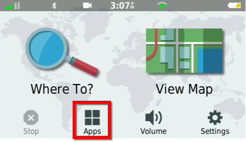

1. Touch Apps

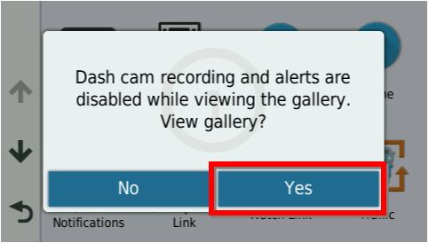

3. Touch Yes to confirm

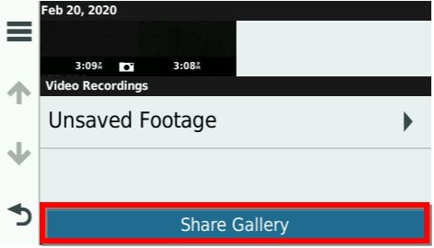

4. Touch Share Gallery

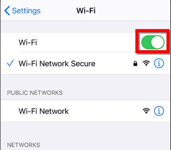

Setting up the Connection on the iPhone:
1. Open the Settings on your iPhone
2. Touch Wi-Fi
3. Enable Wi-Fi
    • Skip this step if already enabled
4. Select the Network Name displayed on the Garmin device
5. Enter the Network Password displayed on the Garmin device
It may take about a minute to display all videos once connected.

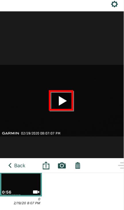

1. Launch the VIRB Mobile App
2. Select the desired video
3. Touch Play icon

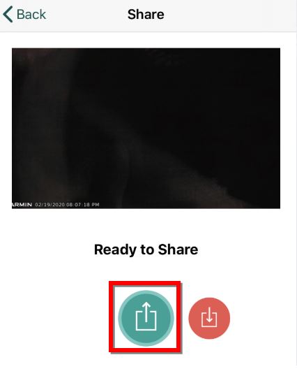

To Share or Download a Video/Photo:
1. Select the desired video in the VIRB Mobile App
2. Touch the Share button (box with an up arrow)

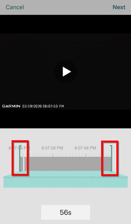

3. Trim down the video as desired by touching and dragging the brackets on either side of the timeline at the bottom of the screen
    • Note: Trimming the video will not delete the original video

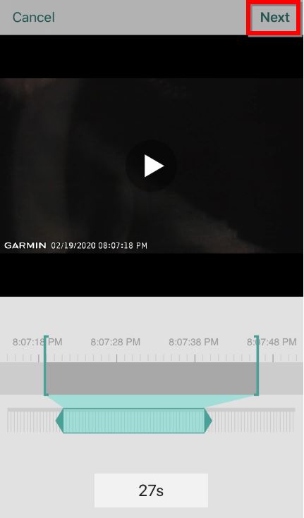

4. Touch Next

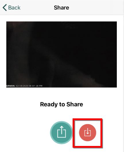

5. Touch the Upload/Share button (box with an up arrow coming out of it)
    • Touch the Download button (box with a down arrow going into it) to save the video/photo to the phone's gallery
6. Select the desired sharing method
You will have sharing options such as text, e-mail, Facebook, YouTube, and more.
You can delete any selected video by pressing the trash can icon on the main screen of the VIRB Mobile App.
