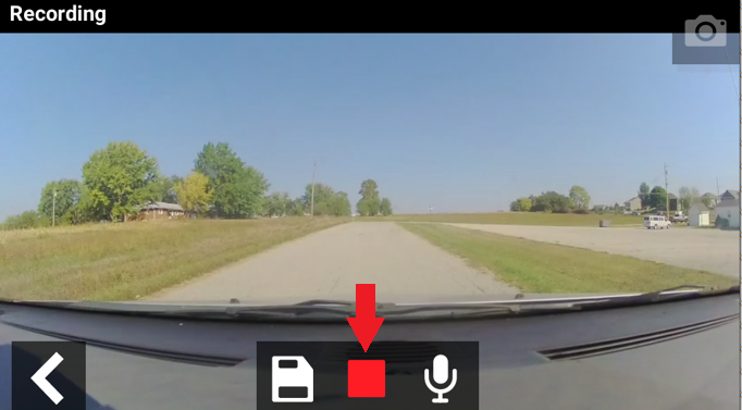

NOTE: The Garmin DriveCam™ 76 will show a not recording, or paused icon on the main menu if it is not recording video. Press the paused, or the not recording icon, then press the  record icon to begin recording.
Example when dash cam is recording:

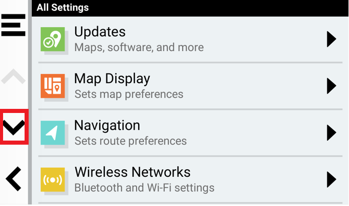

1. Touch Settings
2. Touch the down arrow

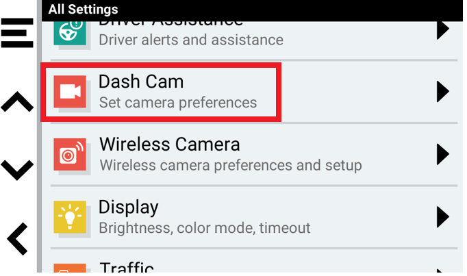

3. Touch Dash Cam

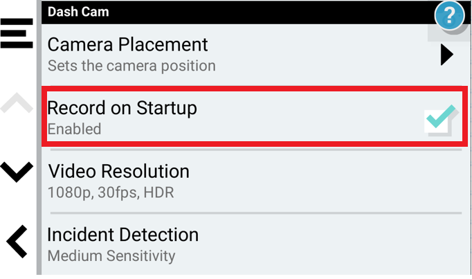

4. If Record on Startup is unchecked, touch it to add a  checkmark

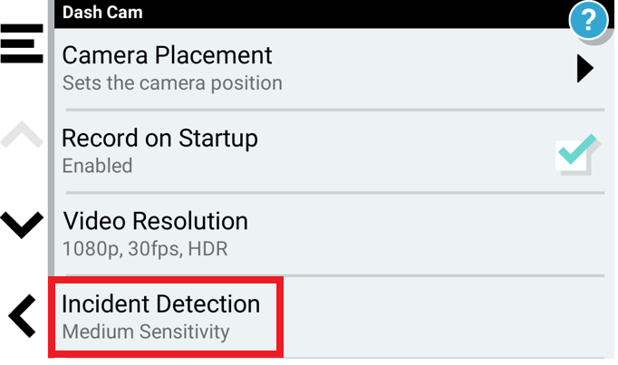

5. Touch Incident Detection
6. Select your preferred incident detection sensitivity, then select Save
NOTE: Selecting Off will disable the dash cam from detecting and saving any incident or impact
The Garmin DriveCam™ 76 device will now automatically save video when it detects an event.
