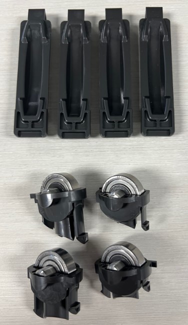

Bearings and Bearing Guides
(Includes magnets)
(S00-01756-05)
bearings and bearing guides - magnets included

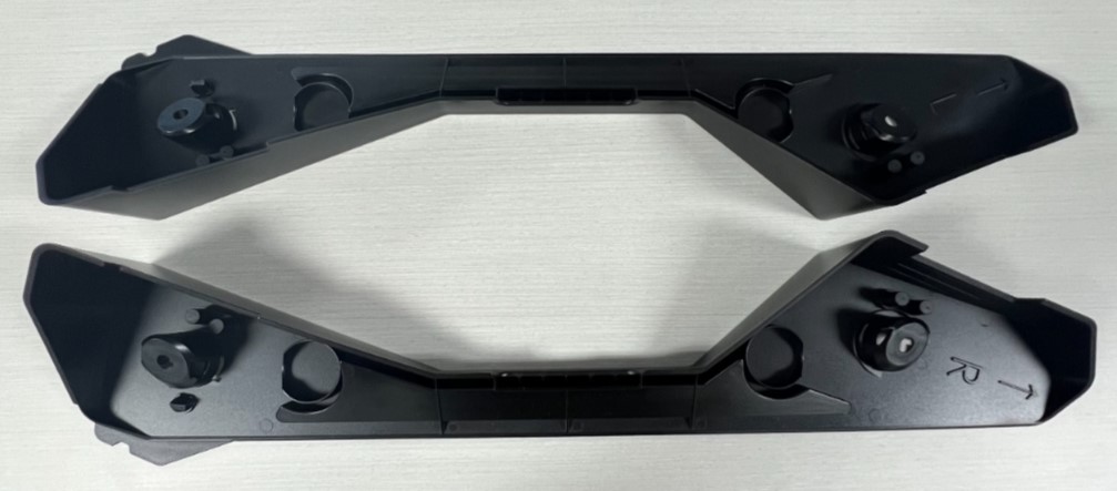

Bottom Plate
Left (S00-01756-00)
Right (S00-01756-01)
bottom plates

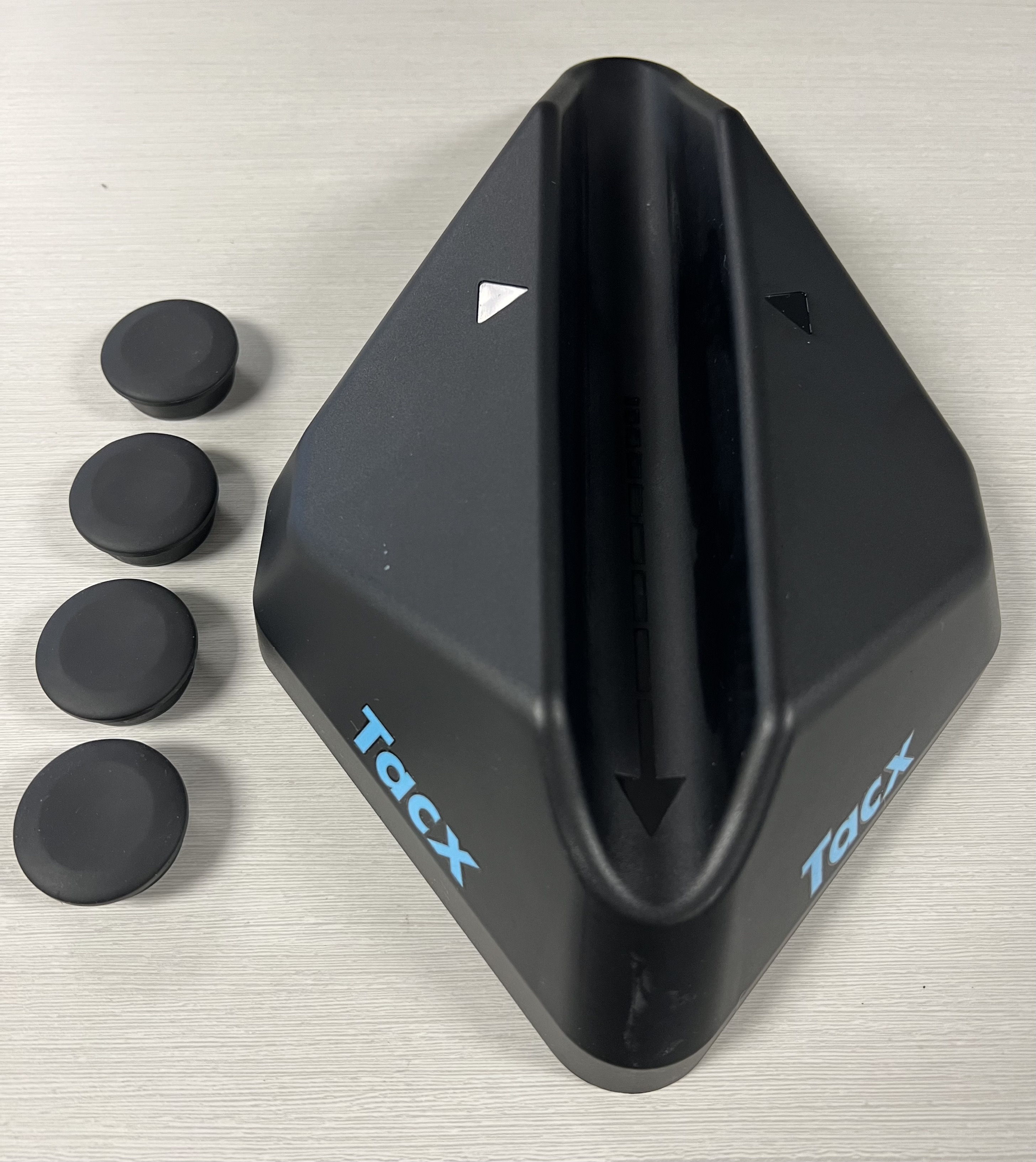

Front Wheel Support and Rubber Feet
(S11-05877-00)
front wheel support with 4 feet

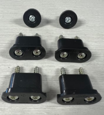

Guide Blocks
(S00-01756-06)
guide blocks and screws

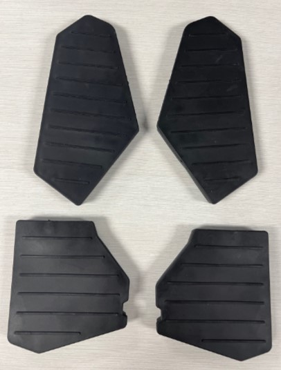

Rubber Caps
(S00-01756-04)
rubber caps

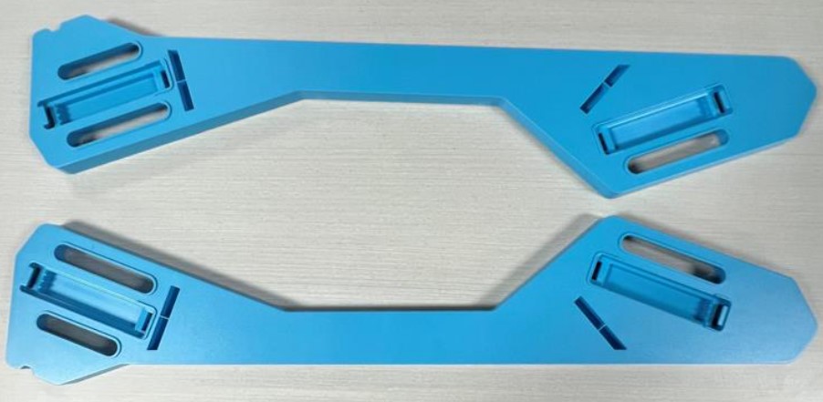

Top Plates
Left (S00-01756-02)
Right (S00-01756-03)
top plates
