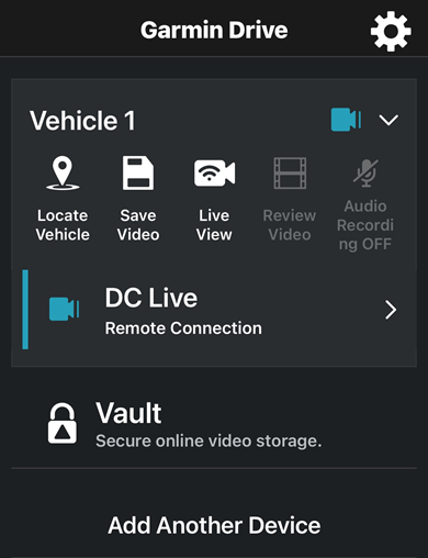

  Remote Connection Options:
   Remote Drive app options
NOTES:
  • The Remote Live View on the Garmin Drive app will be active for up to 5 minutes at a time.  A new connection must be initiated to remotely view again.
  • The Garmin Dash Cam Live will continue recording while viewing the live camera feed.
  • This recording will have audio if audio recording is on, but there will be no audio when viewing the Live View.
  • Starting the Live View while connected to the Garmin Dash Cam Live via Bluetooth will not allow remote access. Once out of Bluetooth range, it will disconnect. Connecting this way will allow you to adjust the camera angle. For instructions, see Viewing Live Feed Video Using the Garmin Drive App.
  • The Live View can be seen in either portrait or landscape orientation by rotating the phone.

Garmin Drive App Set to Enable Exported Clips
Android:
  1. Open the Garmin Drive app
  2. Tap on settings (gear icon in the upper right)
  3. Tap Vault Access
  4. Check DC Live
  5. Check Exported Clips
Apple:
  3. Tap Vault Access
  4. Toggle DC Live on
  5. Toggle Exported Clips on
