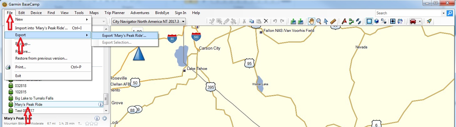

 1.  Select the Adventure in BaseCamp
 2.  Select File on the ToolBar and Export

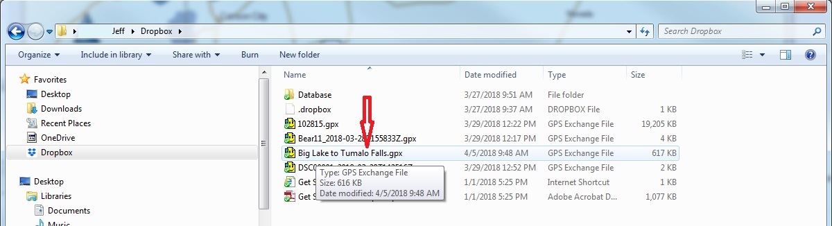

 3.  Select the New Database Location and Click Save
4.  Select the Database location and confirm the Adventure Data has Imported
