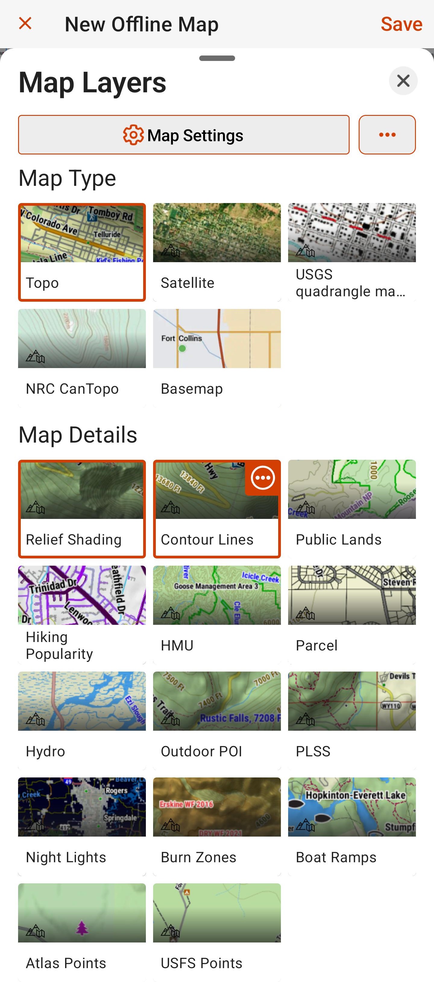

Enabling or Disabling Specific Outdoor Maps+ Content
Use the steps below to choose which maps will be displayed in the Garmin Explore app.
  1. Open the Garmin Explore app.
  2. Select Unfolded Map Symbol Map.
  3. Select Icon of Three Stacked Layers in the top right of the map.
  4. Tap on the different options below Map Type and Map Details to choose what should be displayed on the map.
    Swipe up to view more Map Types and Map Details if needed.
    NOTE: If available, tap three dots in a circle for additional options (e.g. for Satellite Imagery you can toggle Hybrid map on or off).
    Map Layers and Map Details
