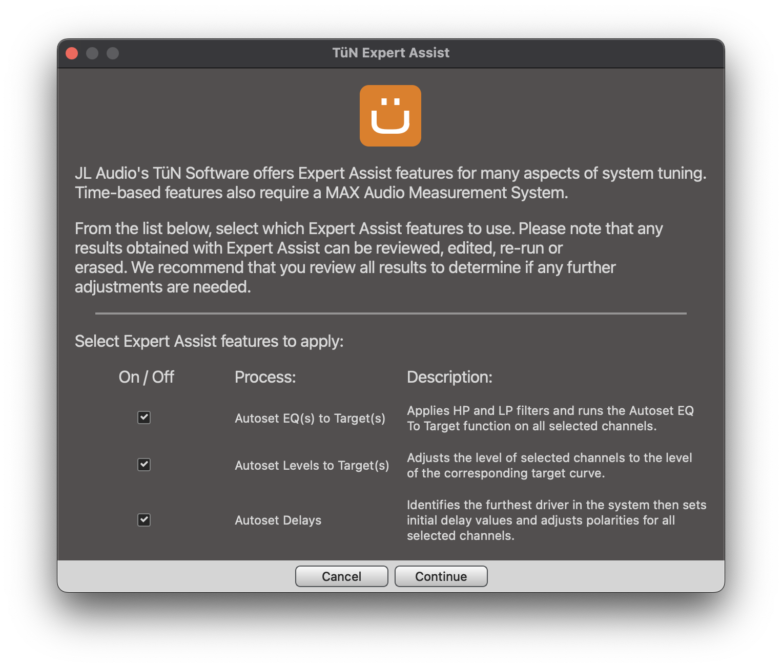

Expert Assist can be accessed on the MEASURE Tab, in the top left-hand corner of the interface. There is an orange button (blue in high contrast mode) with the TüN® Happy symbol. Once this button is selected, a window will appear (see below).
TüN® Expert Assist Dialog Box
As noted in the image, Expert Assist results can be reviewed, edited, re-run or erased. The user has full control over the outcome. This is extremely powerful and will empower the user, not limit their abilities.
There are three options in Expert Assist that can be run either individually or altogether. Autoset EQ(s) to Target(s) and Autoset Levels to Target(s) can be used with any connected microphone(s). Autoset Delays requires a JL Audio MAX™ Audio Measurement System to be connected. Expert Assist can be run successively. For example, if there is a pair of channels being used as a Global EQ (an EQ that affects all channels in the system), a second Assist (Autoset EQ(s) to Target(s) could begin after the initial Assists are completed.
