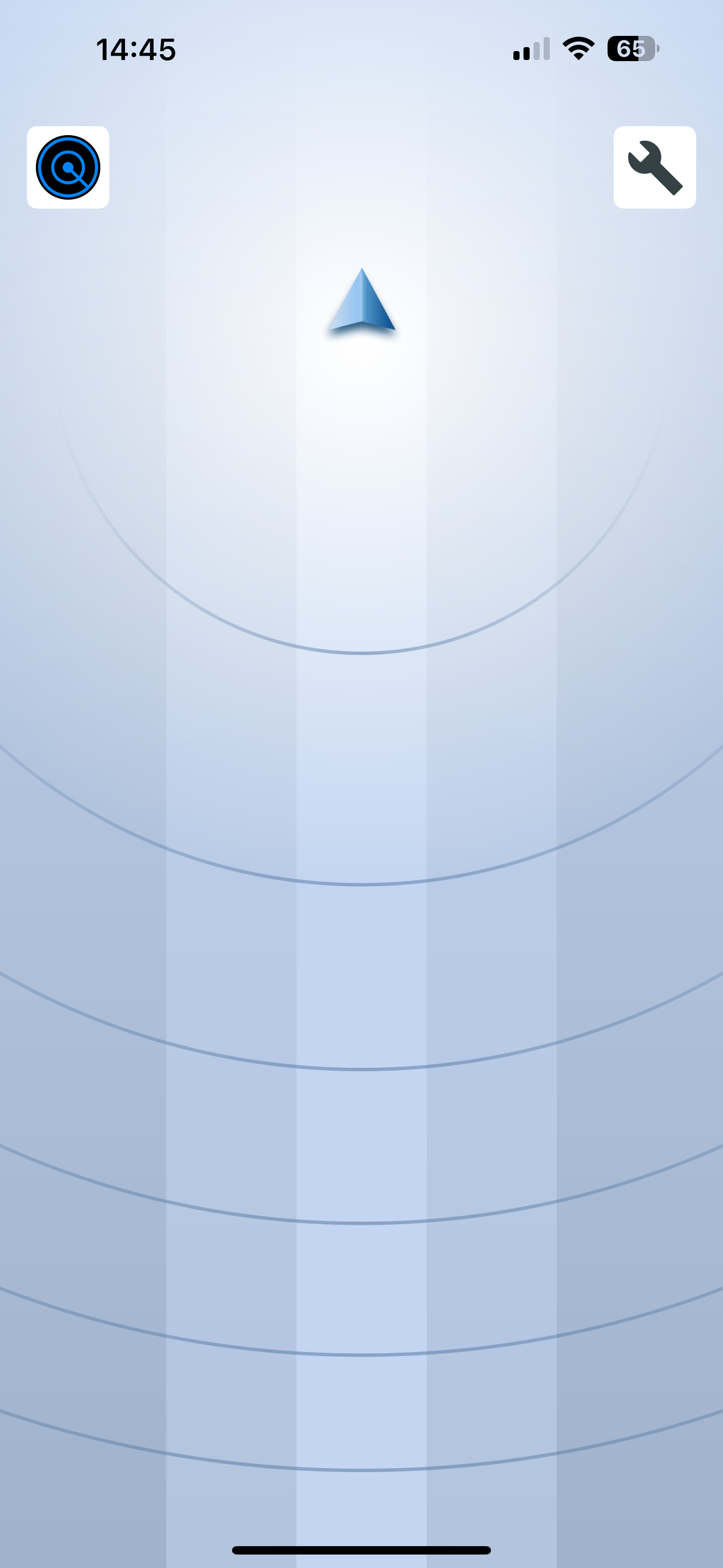

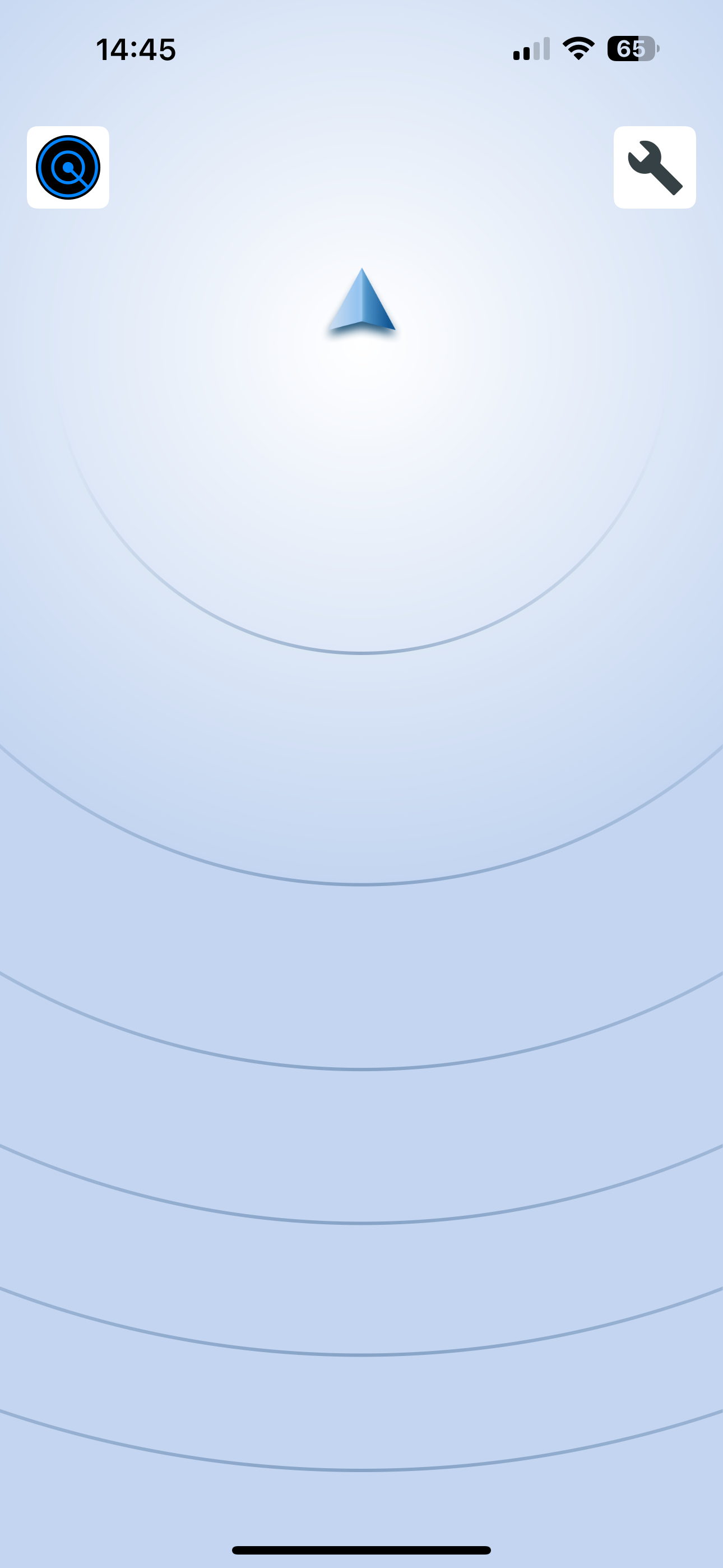

    • From the radar screen, touch the Wrench Icon

    • Alignment Lines - Select to enable or disable the alignment lines displayed on the radar screen, providing an approximate visual representation of the vehicle's path of travel.
