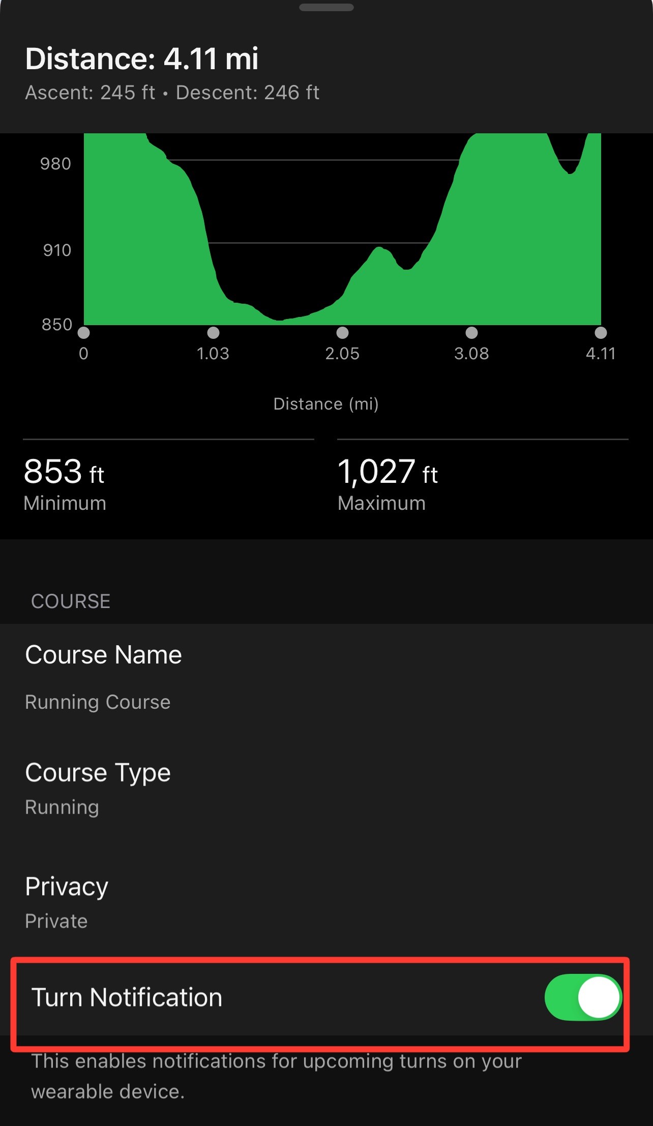

Course Turn Notifications in Garmin Connect
To receive turn-by-turn directions on your watch, the Turn Notification setting must be enabled for that course when creating a course in your Garmin Connect account. For more information on how to create courses and send them to your watch, see Related below.
 Garmin Connect app turn notification screen
