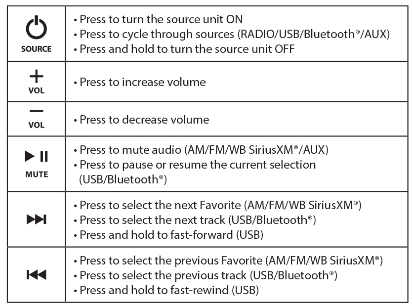

Control Functions
Below is a list of MMR-20 command functions.  The functionality of some controls will vary depending on the current source and/or last tuner selected. Note: The MediaMaster® source unit only accepts commands from the MMR-20 when its display is on a "Now Playing Screen" or in the "SOURCE: Select" menu screen.
JL Audio Media Master Control Functions
