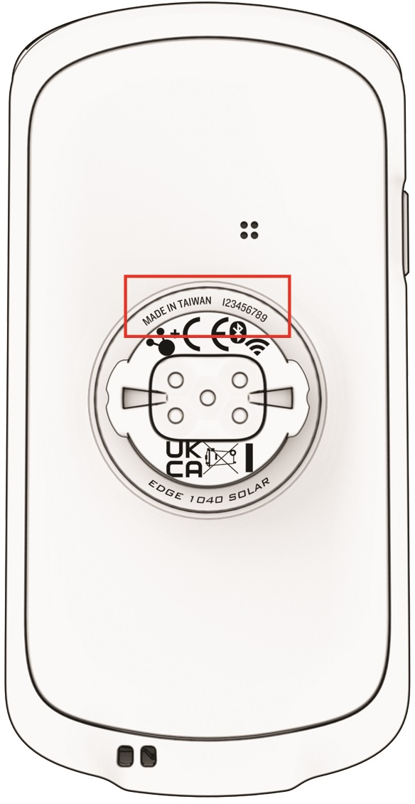

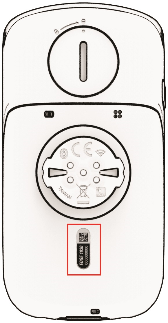

The location of the serial number varies by model:
On the Back of the Device
Edge SN Back Label below turn mount
Edge SN Back Ring

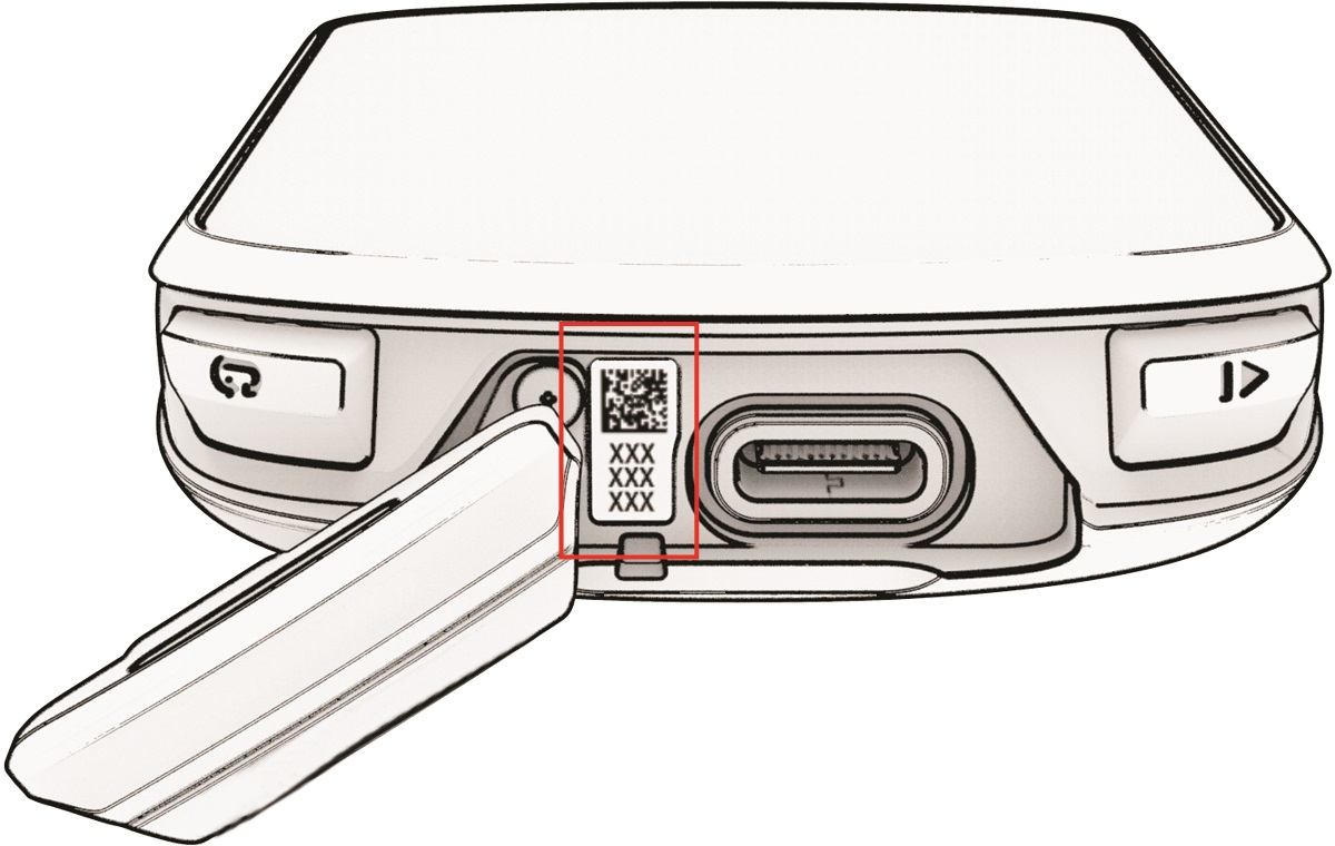

Under the Weather Cap
Edge SN Weather Cap
