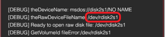

- Note down the DEBUG messages from the Garmin Aviation Database Manager mentioning a raw disk file path ( /dev/rdisk2s1 in this example), keep this file path in mind as we will need it later.
*This is the name of the removable drive's pathway
