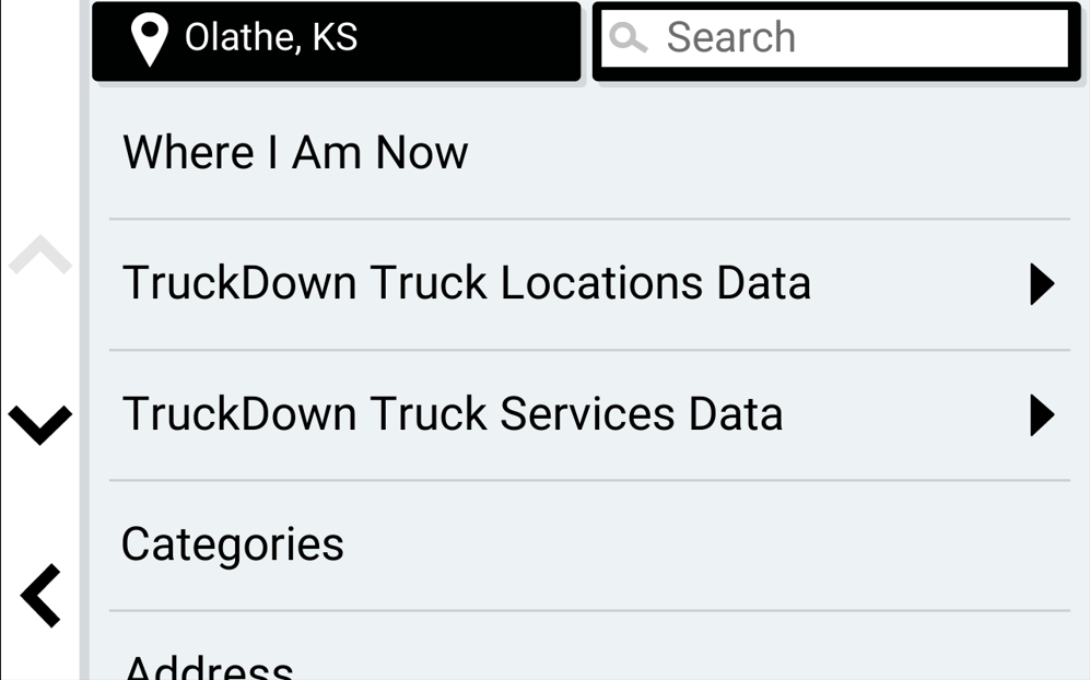

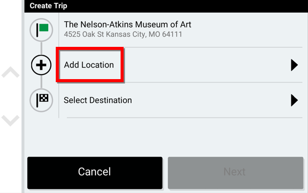

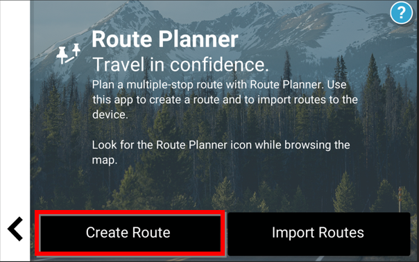

To Create a Route
1. Touch Route Planner
 2. Touch Create Route
3. Touch Select Start Location
NOTE: The Start Location is the first stop on the route. You can use your current location as the starting location, but it isn't necessary. The device will skip your current location if that is where you are when it begins to navigate.

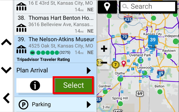

4. Select the starting point using the search options
5. Touch Select
6. Touch Add Location to add a second point
7. Follow steps 4 through 6 to locate and add up to 30 total points. Touch a point to show additional options if changes need to be made.
8. Touch Select Destination and follow steps 4 and 5 to select a destination
9. Touch Next. The route will now calculate

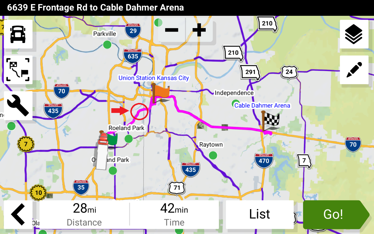

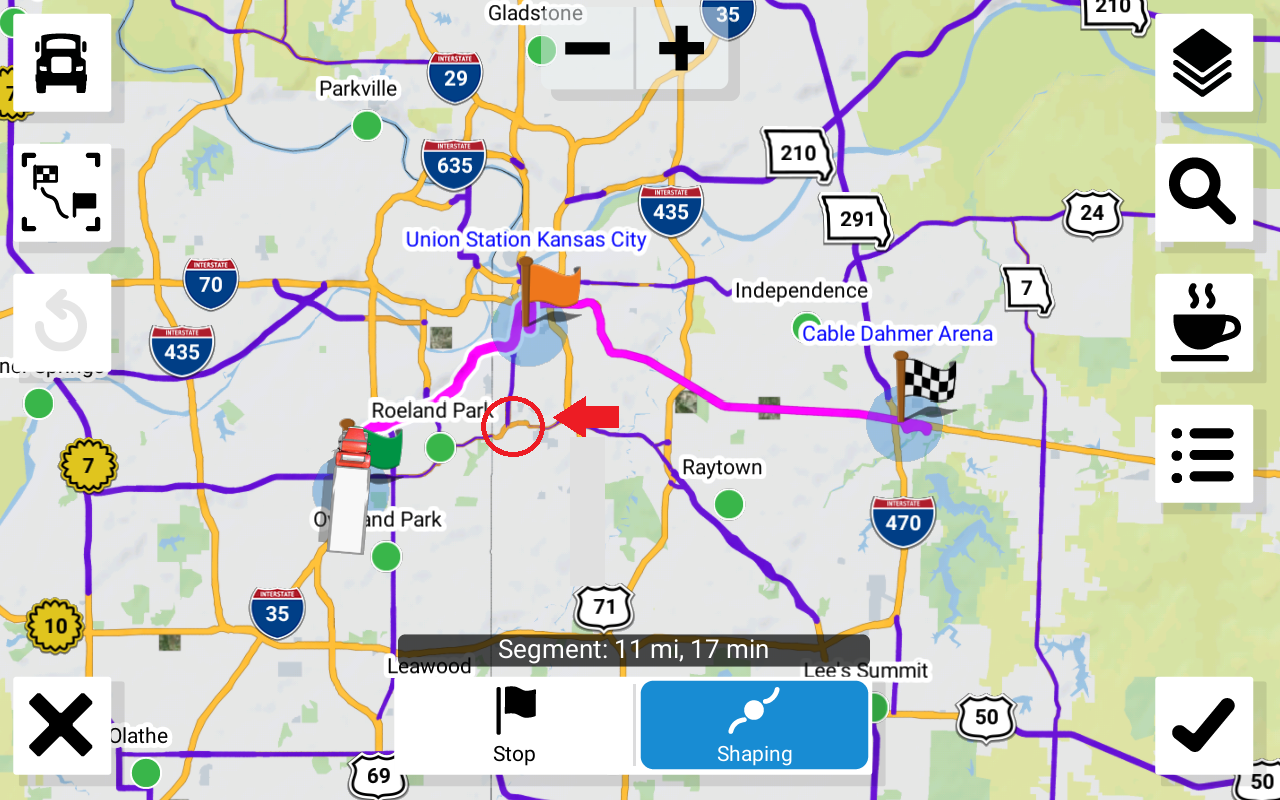

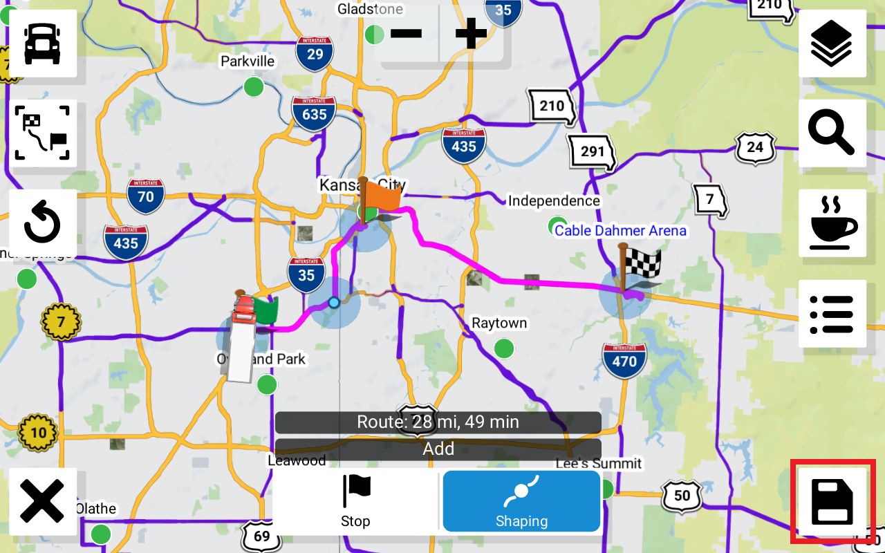

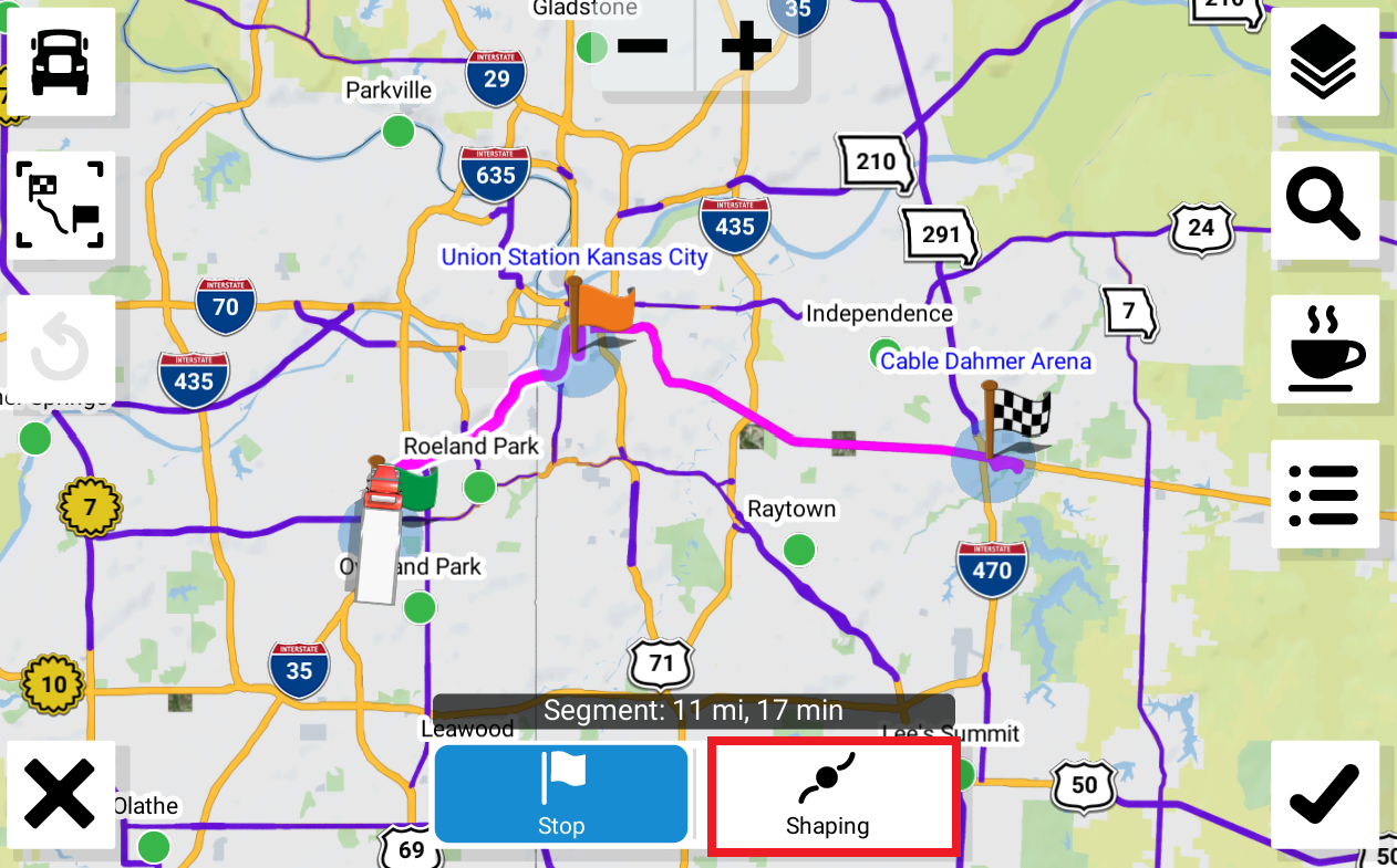

To Add Shaping Points
You can insert shaping points to change how the route navigates.
1. Select the saved route in Route Planner

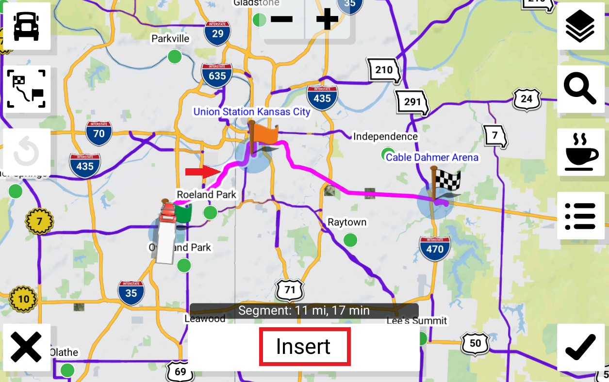

2. Begin by selecting a route segment, which is a section of the route between two locations
dezl OTR x10 select segment 1
3.  Touch Insert
  • The segment will appear as a white highlighted magenta line.
  • Touch the X to remove the segment selection.
dezl OTR x10 select segment 2
4. Touch Shaping
dezl OTR x10 Shaping
5. Touch OK
dezl OTR x10 OK shaping.

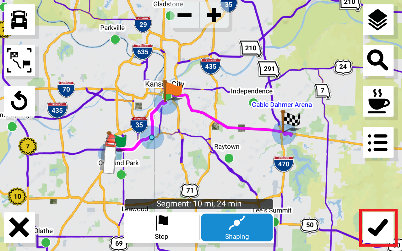

6. Touch a spot on the map to shape the route
dezl OTR x10 Select Point 1
7. Touch the check mark to confirm
dezl OTR x10 Shaping checkmark

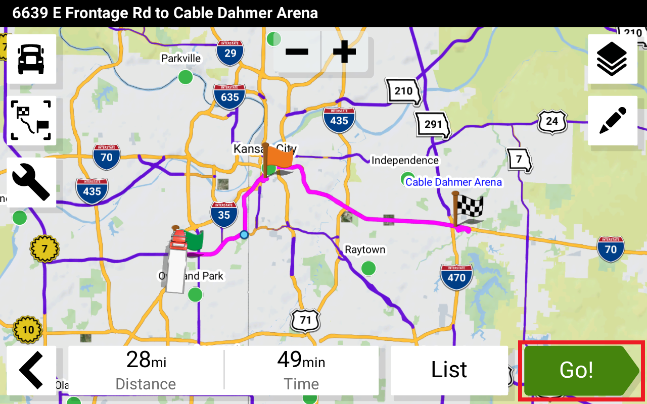

8. Touch the save button to save changes
dezl OTR x10 Shaping Save
9. Touch Go to start the route
dezl OTR x10 Shaping Go

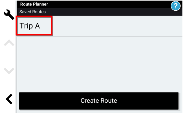

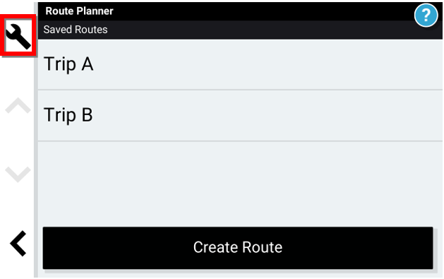

To Edit a Route from the List Screen
2. Touch the name of the route you want to edit
3. Touch List

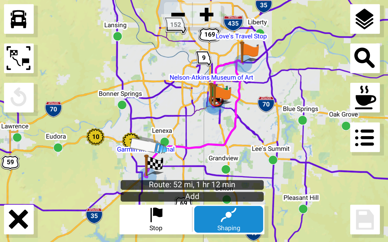

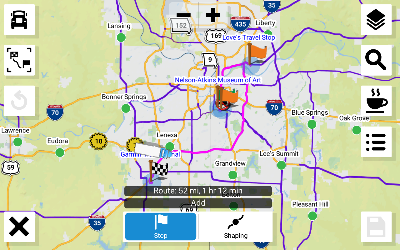

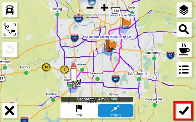

To Edit a Route from the Map Screen
2. Touch the name of the route you want to edit.
3. Touch the Pencil icon
4. Use the options below to edit the route:
  • Touch Stop to add a Waypoint to the route by touching the map
  • Touch Shaping to add a shaping point to the route by touching the map
  • After adding a shaping point, select the List icon, then move or reorder the shaping points as needed.
  • Touch the Three squares icon to enable additional map layers
  • Touch the Search icon to search for Points of Interest
  • Touch the Coffee icon to search ahead along the route
  • Touch the List icon to Reorder locations
  • Touch the Vehicle icon to switch the vehicle profile between car and motorhome
    • The Trip will be calculated based on what vehicle profile was selected for the Trip within the planner, regardless of what profile is currently chosen on the device. Additionally, the Trip will be calculated based on the devices current navigation settings as well; navigation settings cannot be adjusted within the planner.
  • Touch the Route Preview icon  to center the map to display the full route
  • Touch the Undo Arrow to undo any unwanted changes made to the route
  • Touch the Save icon to save any changes made to the route

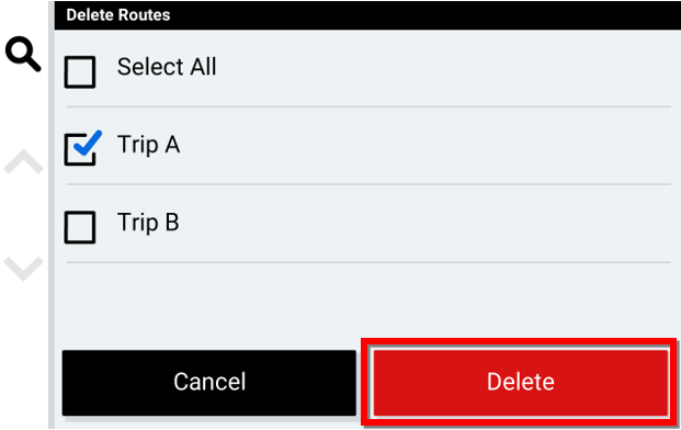

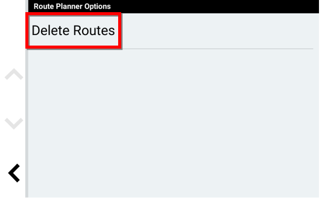

To Delete a Route
2. Touch the wrench icon
3. Touch Delete Routes
4. Select the routes to delete and touch Delete
5. Touch Yes
The selected routes will now be deleted.

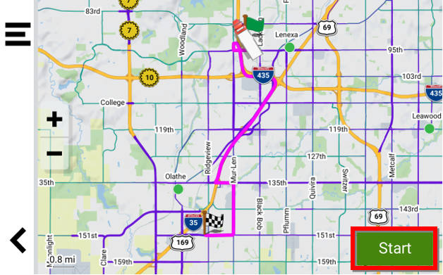

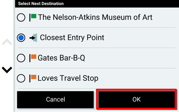

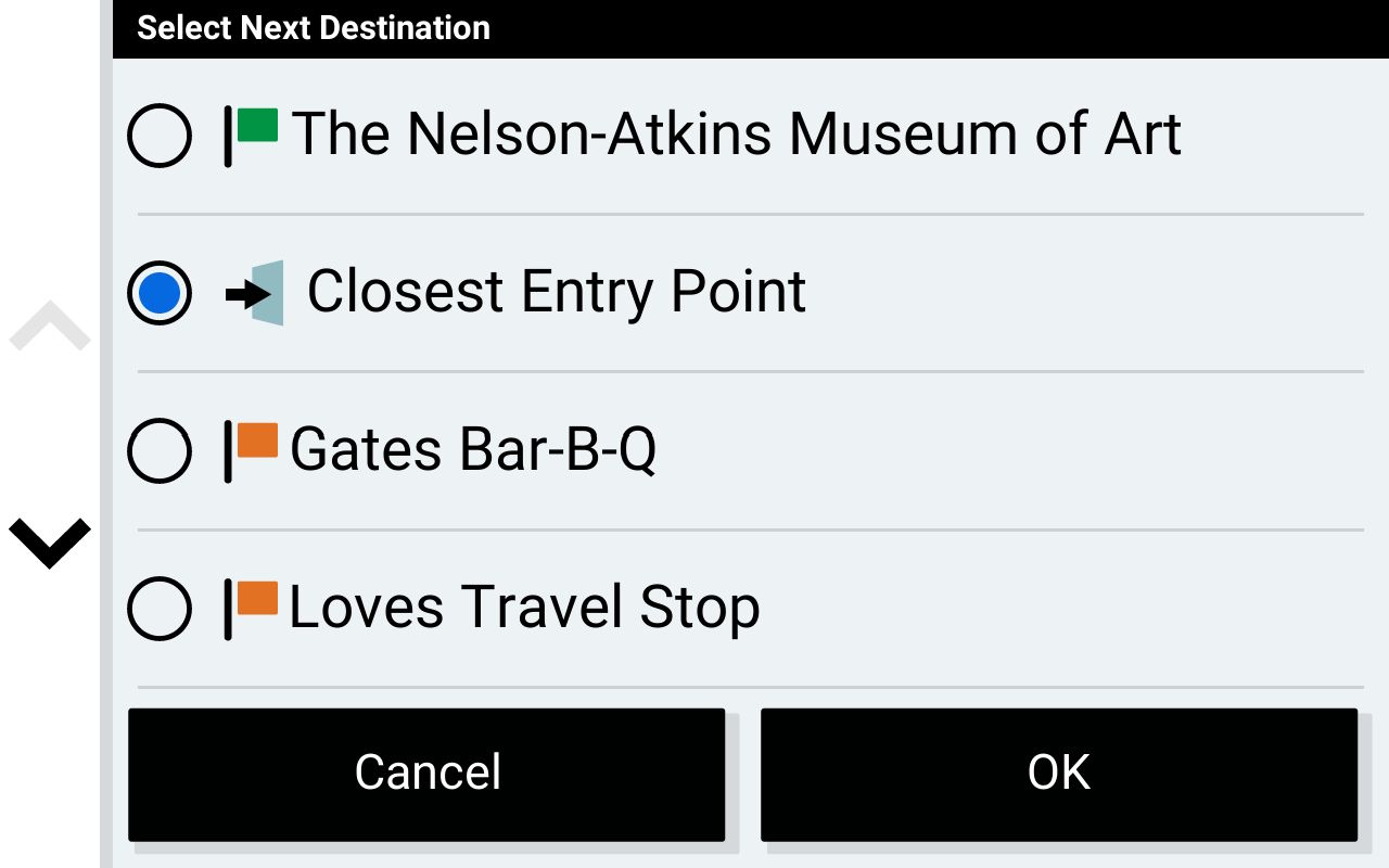

To Start Navigating a Saved Route
2. Select the Route
3. Touch Go
4. Select the Next Destination of the Route
  • Select the Green Flag to route from your current location to the beginning of the route, and then the full route.
  • Select the Orange Flag to skip the starting location and route from your current location to the waypoint selected in the route, and then the remaining route destinations in order.
  • Select the Checkered Flag to route from your current location skipping all the points in the route and taking you the quickest way to the destination point.
  • Select the Closest Entry Point to skip the starting location and calculate the quickest way to get on the planned route.
5. Touch OK
6. Touch Start
