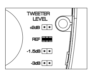

Tweeters sound harsh or bright
Check passive crossovers for level adjustment (attenuation) of tweeters. Try lowering the level of the tweeters in relation to the midrange speakers.

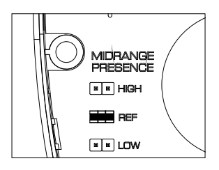

Midrange/Mid Bass is weak or undefined

Inspect the passive crossovers for a midrange adjustment (presence) capability. Try different jumper positions in the passive crossover networks (if available) to see if the system's midrange presence improves to your liking.
