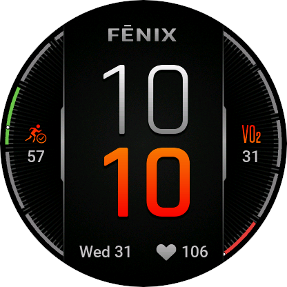

Digital Watch Face With 2 Gauge Data Fields on either Side and 2 Text Data Fields on Top and Bottom

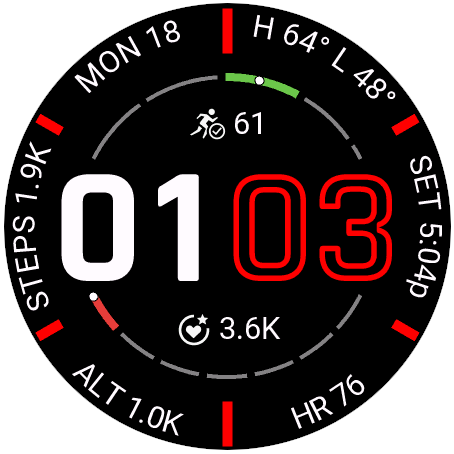

Radial Precision
Adjusting the Styles of this watch face switches between an analog or digital time option.

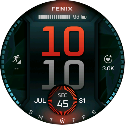

Digital Watch Face With 2 Gauge Data Fields on either Side, 1 Text Data Field at the Top, and 2 Text Data Fields at the BottomBold Stack

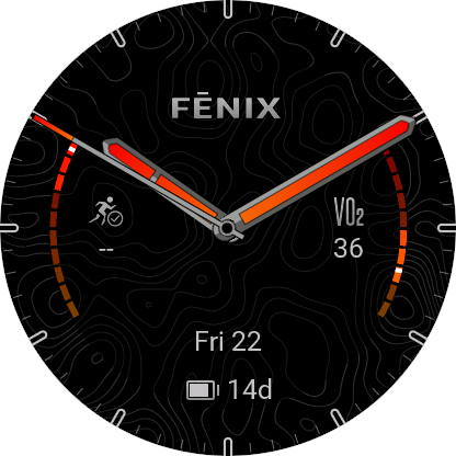

Analog watch face with subtle background of contour lines includes 2 gauge data field on the right and left and 3 text data fields
Contours
Requires Software Version 12.22 or newer.

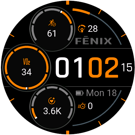

Digital watch face with 2 arc gauge data fields and 1 text data field on the right and 3 circular data fields on the left
Industrial
Requires Software Version 11.89 or newer.

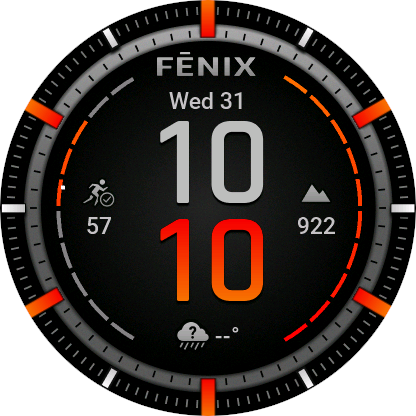

Digital watch face with data fields around the outside edge
Portal
