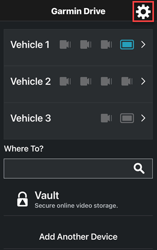

1. Tap the Settings gear.
Settings Gear Drive app

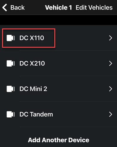

2. Tap the Vehicle name, then select your device.
Drive app Select device in vehicle settings

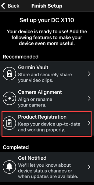

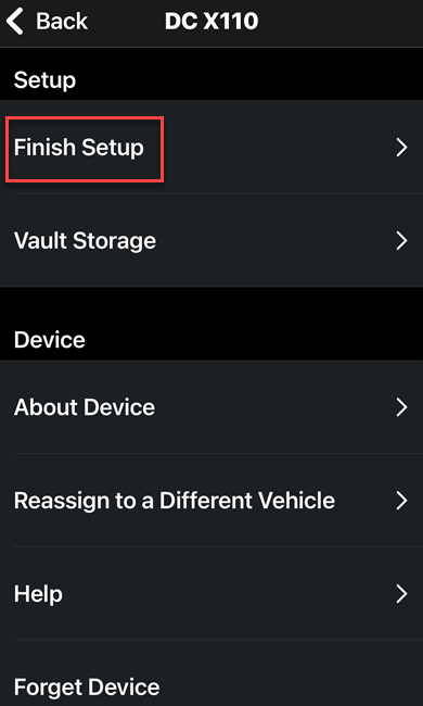

3. Tap Finish Setup.
Drive App Finish Setup
4. Tap on Product Registration, if available.
Drive App Product Registration

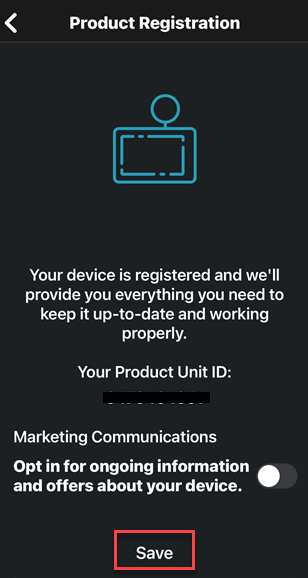

5. Tap on Save
Drive App Save Product Registrationp;
The device will be registered to the email used when signing in to your Garmin account in the Garmin Drive app.  See the example in step 12 of Pairing a Garmin Dash Cam with the Garmin Drive App.
