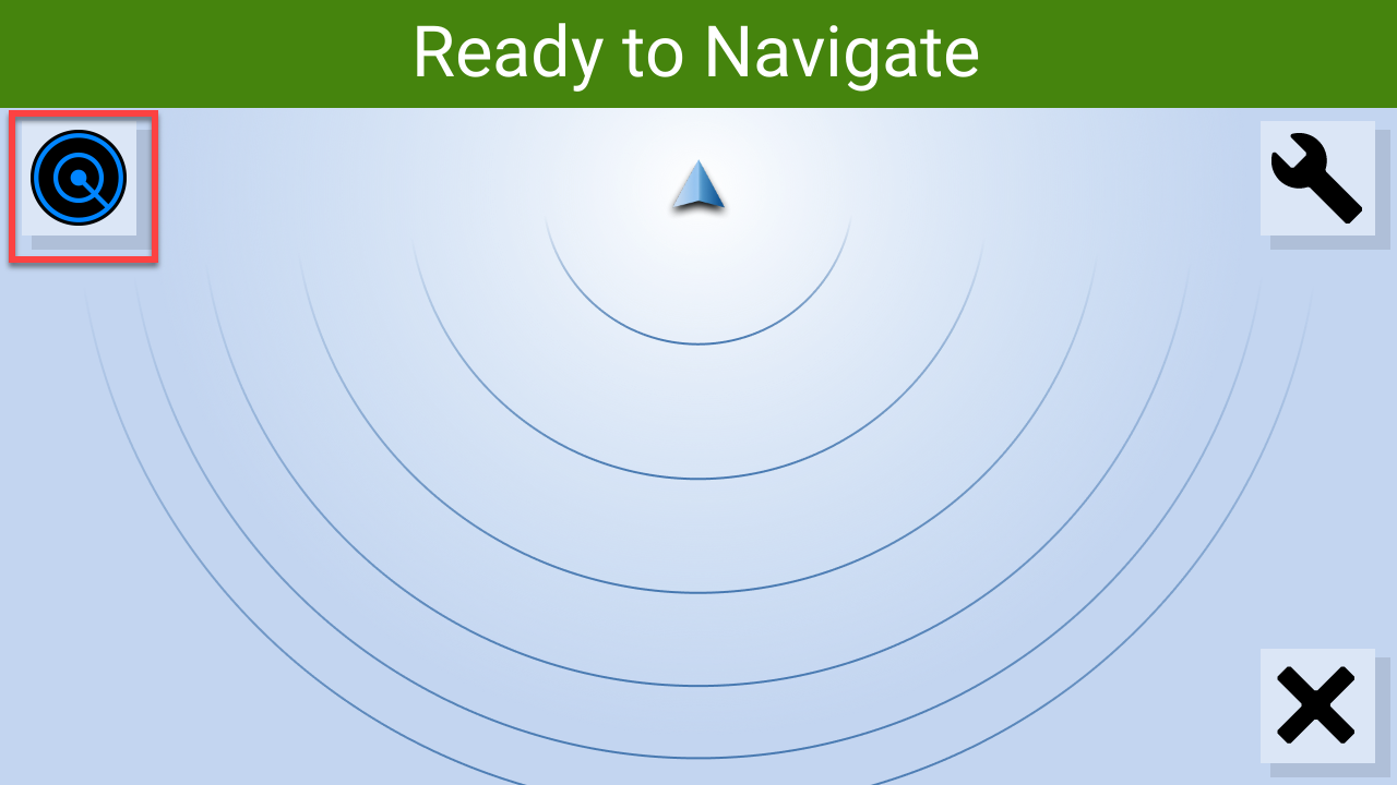

Understanding Radar Status Icons
In the top left of the Radar display screen, you will see a Radar Status indicator.
The color and symbol of this icon indicates its status:
 Green Radar
  • The radar is active and detecting vehicles approaching from behind and in your blind spots.
 Blue Radar
  • The vehicle is traveling at low speed, and radar features are limited. You may see reduced detections and alerts.
Orange Radar
  • The radar is disabled and cannot detect any vehicles. Verify the radar is not blocked. Rain and other precipitation can also affect radar performance.
 Red Radar
  • The radar is disconnected and cannot detect any vehicles. Check bluetooth and power connections.
 Pink Arrows
  • Displays under the radar status symbol
  • The radar is currently performing a software update. Radar functionality is disabled until the update is complete.
Orange Exclamation Mark
  • The radar is receiving frequency interference. You may see reduced detections and alerts. Verify the radar is not near other electronics which may cause interference.
 Red and Black Thermometer
  • The radar is overheating and could indicate the device is operating outside of the operating temperature range. The radar is not operational. Ensure your device is mounted as far away from heat sources on the motorcycle as possible. Avoid parking your motorcycle with the device in direct sunlight. Displays under the radar symbol
