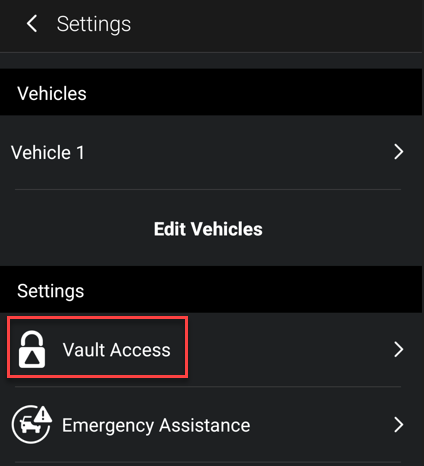

3. Tap Vault Access
Vault Access 1
4. To turn the Vault settings on or off, switch the buttons on the right as shown below (slide bar on iPhone , checkmark box on Android):

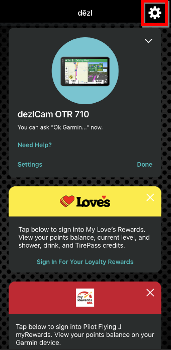

2. Tap the settings gear icon
