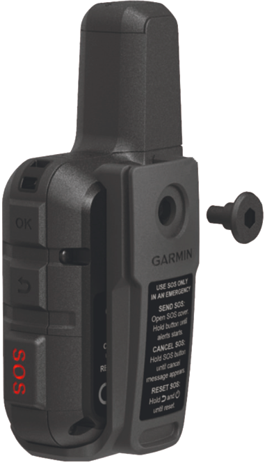

Under the Mounting Bracket on the Back
inReach mini back view
