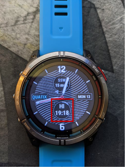

Next, a data field will need to be set up on the watch face.
  1. Press and Hold Up/Menu
  2. Select Watch Face (some have larger data fields)
  3. Swipe Up/Down on the screen or use Up/Down buttons to select the watch face
  4. Press Start/Stop
  5. Select 'Data'
    • The active data field will flash
  6. Push Up/Down buttons to cycle through data types
    • Tides will list as  'Hi' or 'Lo' and a time below it (see image)
  7. Press Start/Stop
  8. Select Apply
qautix 7 data field with red box to indicate data field
