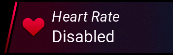

Is the Heart Rate Sensor Turned Off?
Newer watches will show "Disabled" in the heart rate glance. Heart next to heart rate setting disabled indication

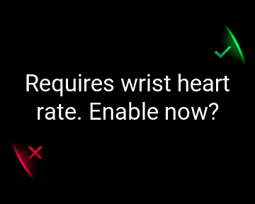

Selecting this glance should give you the option to enable the Heart Rate sensor.
Enable heart rate sensor request with red X in the bottom left and green check in the top right
