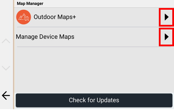

To Enable the Mapping:
1. Touch Settings
2. Touch Map Display
3. Scroll down and touch Map Manager
4. Touch an arrow to expand the map list

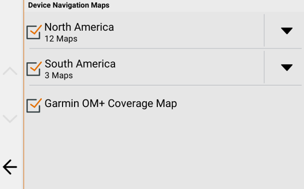

The following screens will appear, based on which arrow is selected.
Touch the down arrow to expand the map list and make note of the name of the map region, which is listed next to the map version.

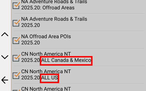

Devices loaded with North America mapping will have the map displayed as two separate entries:
- CN North America ALL Canada and Mexico
- CN North America ALL US
See the FAQ North America Map Regions for more information
If your device does not have both of the above entries, see the FAQ Maps Missing After Updating Maps on a Full Coverage Automotive Device for further troubleshooting steps.
