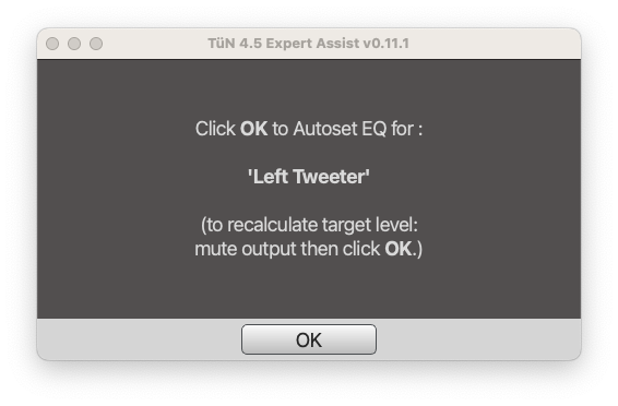

JL AUdio Autoset EQ Dialog Box for Left Tweeter
Image Shows Autoset EQ Dialog Box for Left Tweeter
When Expert Assist is performing the Autoset EQ To Target procedure, it will move the Target’s position to the level of the measured data. It will then give the user an opportunity to make any changes to either the measured data or the Target before clicking “OK” to Autoset EQ. The output channel level and or crossover points can be adjusted so that it fits the Target better or if needed, the Target crossovers can be adjusted as well.

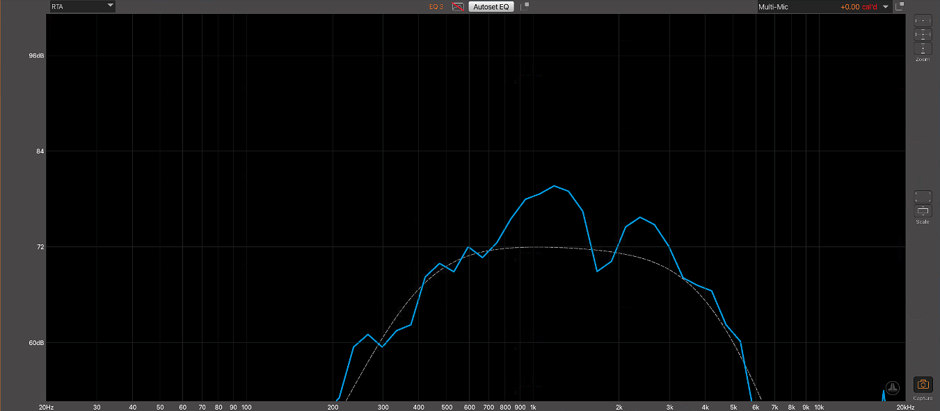

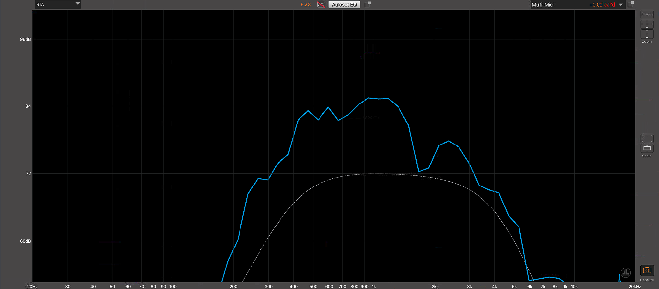

Below are examples of proper and improper alignments to the Target before clicking the “OK” button.
improper alignment of signal compared to Target
Image shows improper alignment of signal compared to Target
Image shows proper alignment of signal compared to Target
