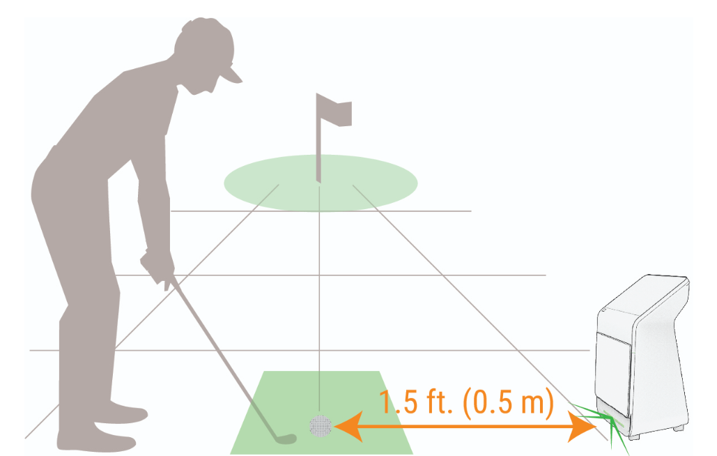

Approach R50 Placement
When selecting a location for the launch monitor for a virtual round or practice mode session, you should observe these considerations:
  • Place the launch monitor approximately 1.5 ft. (0.5 m) to the side of the tee location.
  • The launch monitor must face the tee location.
  • Place the launch monitor at approximately the same height as the tee location.
  • You must have a hitting space or mat at least 2 feet long by 2 feet wide.
  • Ensure you can take a full swing comfortably in your hitting space.
R50 placement setup diagram with person holding golf club
For more information on placement guidelines for your Approach R50 see Tips to Improve Your Approach R50 Setup.
