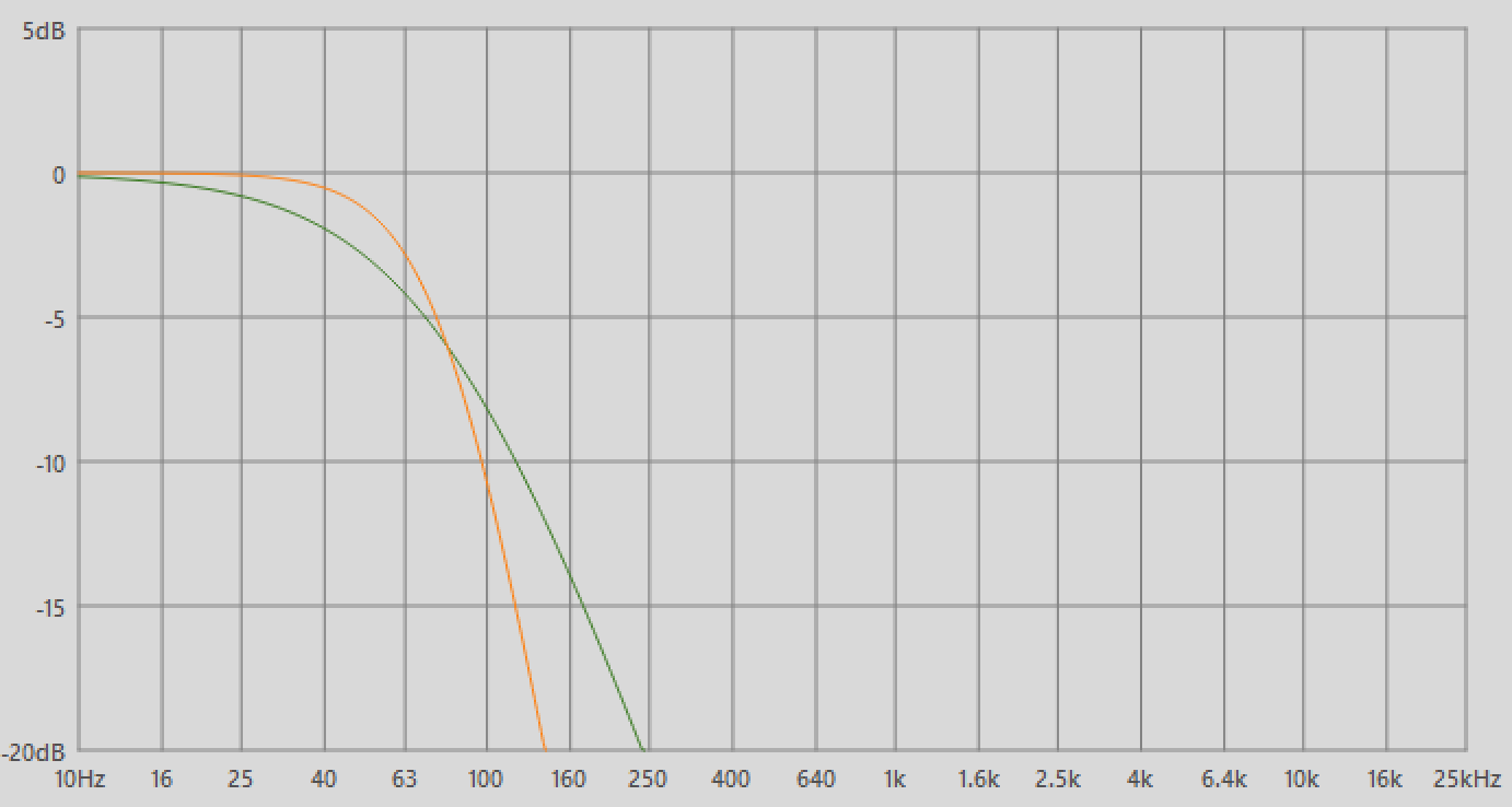

The most commonly used slope options found in car audio are 12 dB per octave or 24 dB per octave.  If adjustable, try switching the slope and listen for any improvements in sound quality.  If you don't like what you hear, simply switch it back.
12 dB per octave slope green vs 24 dB per octave slope orange on a LPF set at 80 Hz
12 dB per octave slope (green) vs 24 dB per octave slope (orange) on a LPF set at 80 Hz.
A 12 dB per octave slope is a more gradual cut off and is sometimes useful in coupes or sedans that have the subwoofer(s) in the trunk. The rear seat material acts as a filter which can reduce upper bass range amplitude. The more shallow slope of 12 dB per octave will allow a bit more bleed through of frequencies above the filter frequency to help counter this.
A 24 dB per octave slope is a more abrupt cut off and is often used in open vehicles such as hatchbacks, wagons and SUVs, since the bass does not filter through seat material. Furthermore, since a 24 db slope is more abrupt, it can sometimes allow for a a slightly lower crossover point between the tweeter and midrange while still maintaining safety.

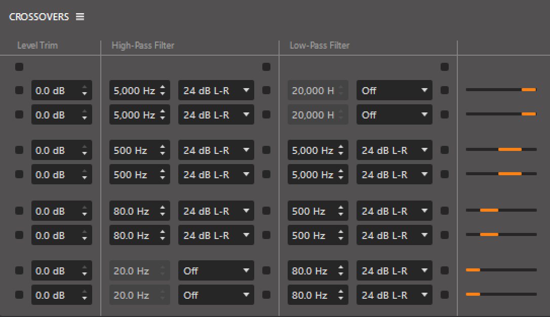

Another solution is to use Digital Signal Processor (DSP), such as a TwK™ D8 or TwK™ 88.  A DSP will often provide more slopes and more precision when creating crossover points, as well as many other useful tuning features.
The Crossover panel from TüN software for the TwK 88 and TwK D8
The Crossover panel from TüN™ software for the TwK™ 88 and TwK™ D8
The advantage of an active system is that it gives you virtually infinite control over the crossover points and slopes. This allows a more precise level match between each speaker. It also allows each speaker to have its own independent equalization.  This can very well be the difference between a good sounding and a great sounding system.
