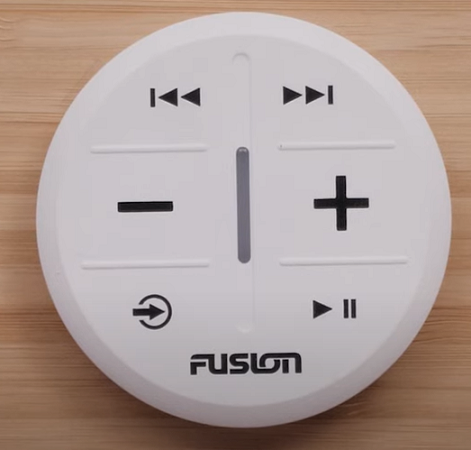

Changing the Battery on a Fusion® MS-ARX70 Wireless Remote
The Fusion® MS-ARX70 remote uses a CR2032 lithium coin-cell battery. With regular use, a battery can last at least 3 years so it may be necessary to replace it over time.

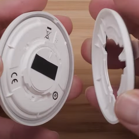

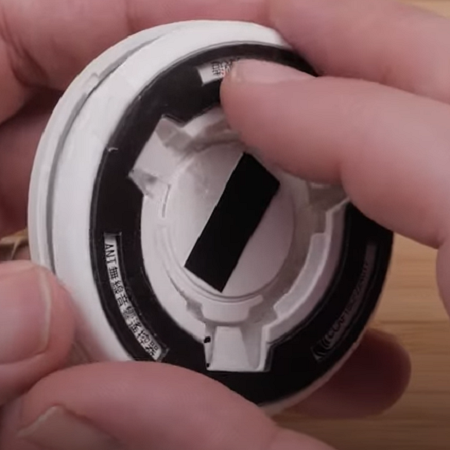

Remove the back case mount from the remote
Holding the back case mount, turn the remote counter-clockwise until it separates

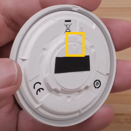

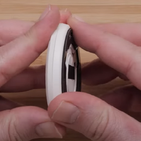

Remove the battery cover
Using the marked slot, turn the battery cover counter-clockwise until it separates from the remote

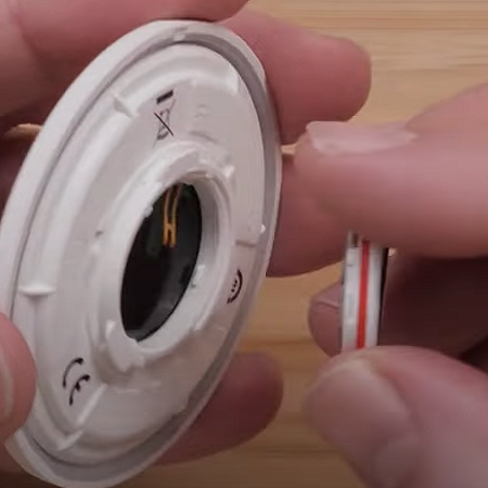

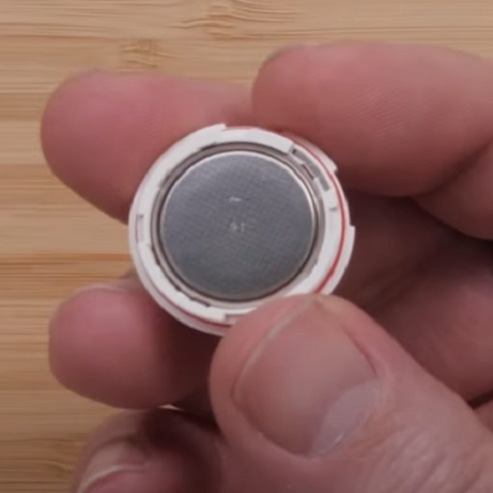

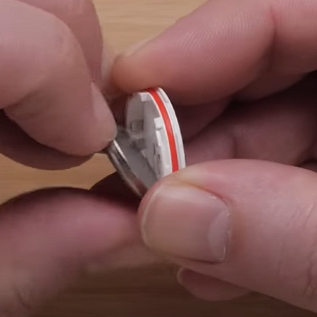

Remove the battery from the cover
Replace the battery inside the cover with the smaller edge of the battery facing out

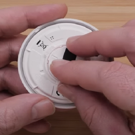

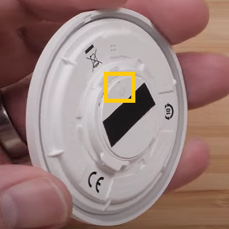

Replace the cover on the back of the remote and turn clockwise until the line points to the lock symbol
Replace the back case mount on the remote and turn clockwise until it clicks
