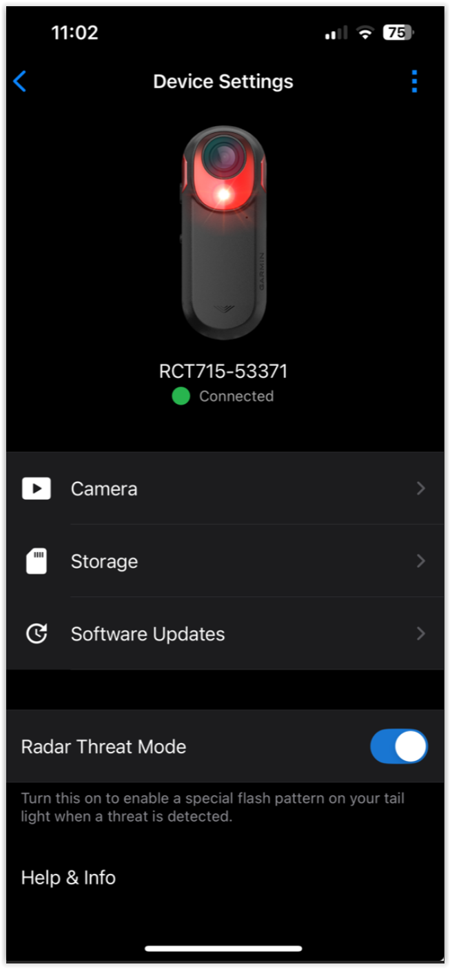

Toggling Radar Threat Mode on Your Varia
  1. Open the Varia™ app.
  2. Power on your compatible Varia radar and connect it to the app.
  3. Select the device icon with the green dot at the top of the page.
  4. Toggle Radar Threat Mode on or off.
    Device Settings menu of Varia App with a Varia RCT715 connected and Radar Threat Mode enabled
