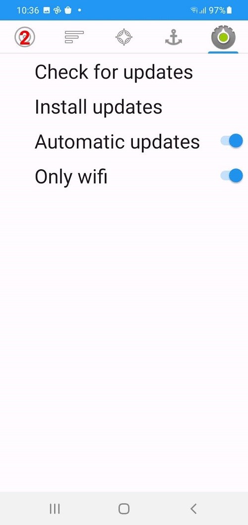

Check that automatic update is turned on:

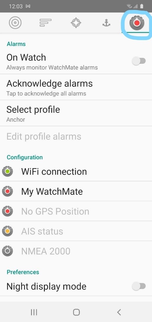

  2. Open the WatchMate app
  3. Tap the alarm/config button on the top banner
  4. Scroll down to System
  5. Tap Firmware updates
  6. Ensure Automatic updates is enabled

  1. Tap check for update

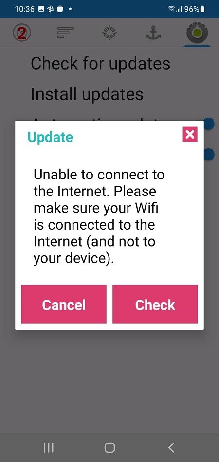

  2. A prompt will appear requesting the Android device be connected to an internet source. Go to the Android Wi-Fi settings and change to cellular data or a traditional Wi-Fi source

  3. The app will then check for a firmware update. The progress wheel will spin
  4. Once an update is found it will download and can then be installed from this page after reconnecting to the XB8000 Wi-Fi again
