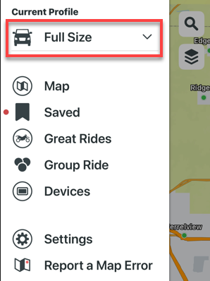

2. Select the Menu icon
Tread App Menu 2

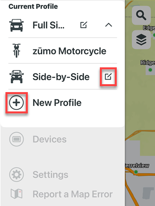

3. Select the current profile
Tread app current profile
4. Select a profile to editTread app edit icon or add Tread app add route icon a new profile
Tread app edit or add profile 1
5. Select a vehicle profile option to customize, then tap Save.
  • Options may vary by vehicle type, e.g. Full Size, Side-by-Side, Snowmobile, Motorhome
Tread app Edit profile Save
After the edits or adding a new profile has been made, the profile(s) will sync to the connected GPS device.
