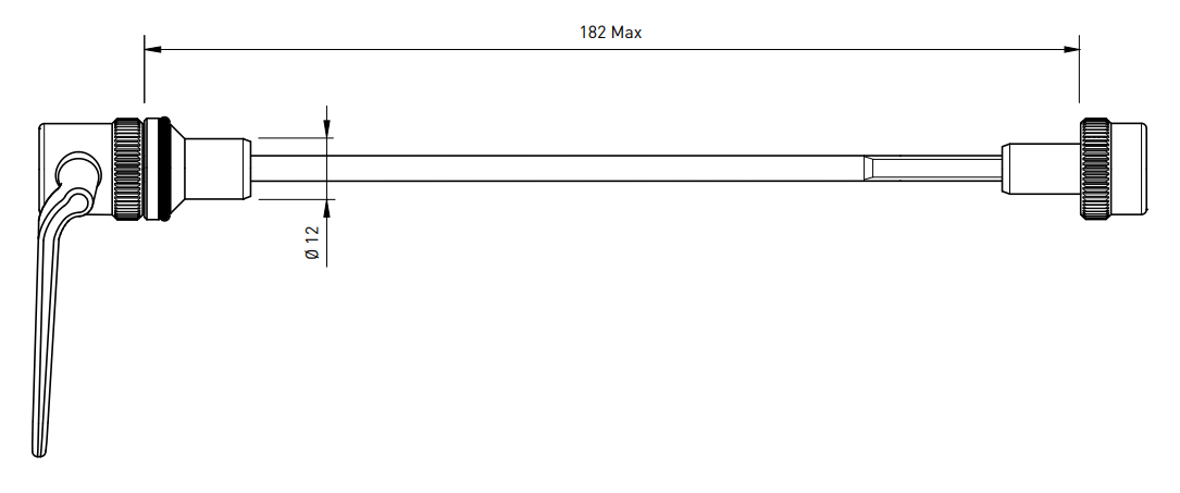

E-Thru 10 mm (T1706)
Diagram of E-Thru 10 mm (T1706)
E-Thru 12 mm (T1707)
 Diagram of E-Thru 12 mm (T1707)
E-Thru M12x1.75 (T1708)
Diagram of E-Thru M12x1.75 (T1708)
E-Thru M12x1.5 (T1710)
 Diagram of E-Thru M12x1.5 (T1710)
E-Thru M12x1 (T1711)
 Diagram of E-Thru M12x1 (T1711)
Trainer Adapter for X-12 Axle (T1709)
 Diagram of Trainer Adapter for X-12 Axle (T1709)
Axle Adapter Kit for Tacx FLUX and NEO Trainers (010-13143-00)
 Diagram of Axle Adapter Kit for Tacx FLUX and NEO Trainers (010-13143-00)
